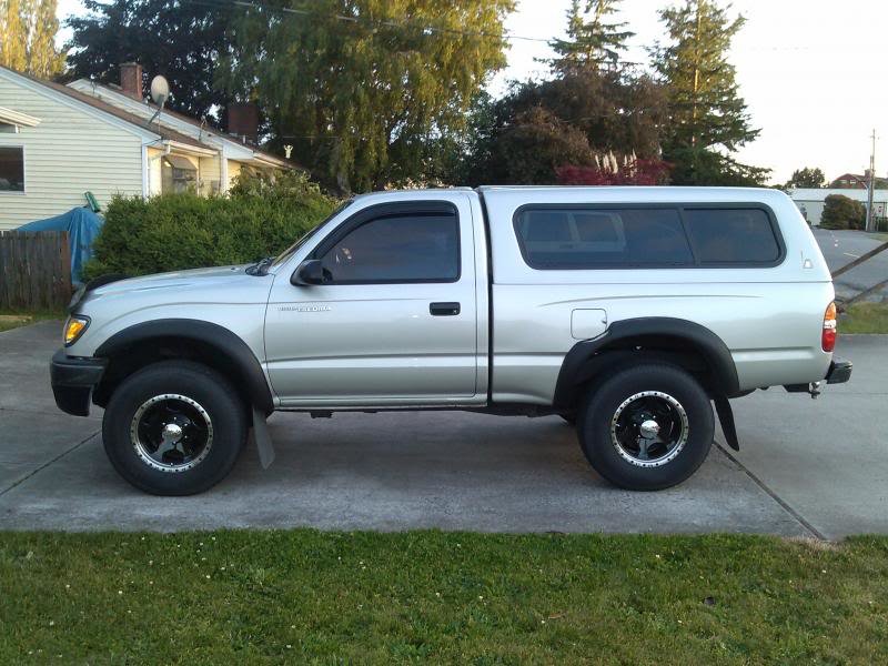

    There can only be one.....................
    Nice looking 1st gen!

    Ditto!
    Yours looks like mine except for my ARB Bull bumper, which has paid for itself in the damage protection it has given me over the years.
