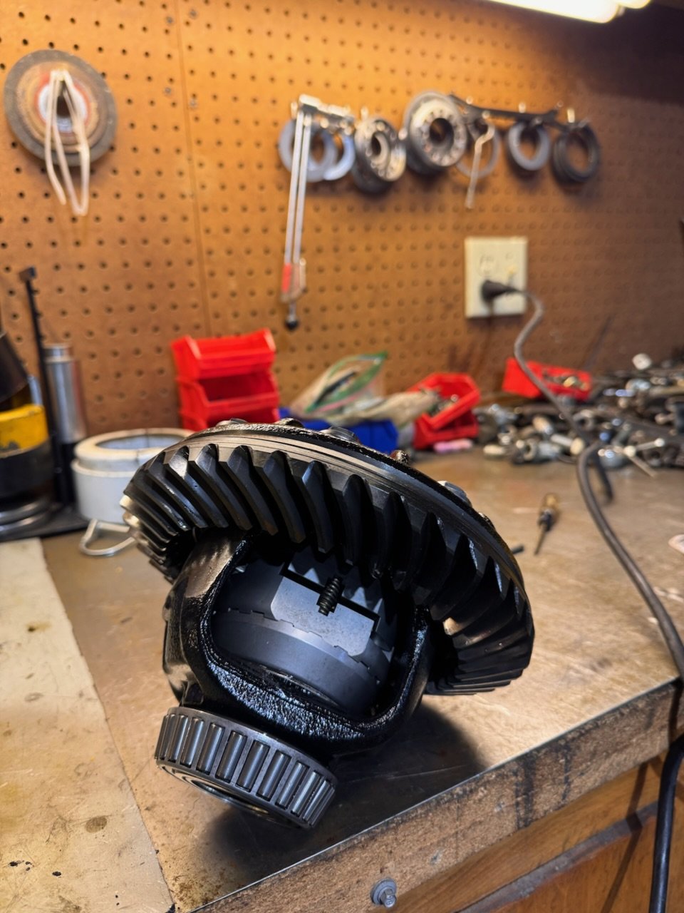

    I got the Torq locker installed on my truck on Monday. My first impressions are highly positive:
    in 2WD, it is absolutely invisible. It makes no sound, and it does not affect steering. I have logged both city and highway miles and looked for any pull on the steering, or any affect at all, and there is absolutely none.
    In 4x4, the truck’s turning radius is not noticeably affected from regular 4x4. You point the front tires where you want to go, and go.
    The locker is throttle activated; if you give it gas, it locks. The turning radius with the front locked (i.e. stepping on the gas in a turn) is tighter than the turning radius with the rear locked (unless you hammer the gas enough you break traction on front or rear, causing either understeer or oversteer.)
    To be honest, I delayed installing a front autolocker for years because of all the doomsayers on Tacomaworld — none of whom had actually run an autolocker in their Tacoma. My current findings with the Torq locker are that much of that doom is overstated and in some cases outright false.
    To be sure, I plan to try to find some snow this weekend in the Cascades, to fully exploit the strengths and weaknesses of the Torq locker; will report back here.
    (Of note: You need a 4-cylinder carrier in the front differential housing to install this. That costs another $375. I already happened to be running the correct carrier from a gear swap I did a few years back, so this upgrade cost me less than $1K total — the cost of the locker, the gear oil, the axle seals, and labor for install, which, if you have a garage and tools (I don’t have a garage), you can do yourself.)
