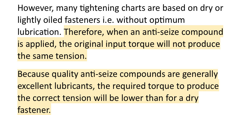

    I will say if you're adding enough to make it reduce torque its too much.
    On a new lug stud, I can flick the nut on all the way to the rim with the tips of my fingers.
    On a vehicle with 2 or more years, you cannot. There's resistance.
    So a tiny dab of anti seize helps alleviate that resistance. Not overwhelm the stud.
    This is real world experience, not a lab with soaking wet bolts that are in prime condition.

    And simple search will reveal by more than one expert that it’s not recommended to put anti sieze on lug nuts or wheel studs. But the torque value should be lowered by approx 20-25%.

    But that's what Bishop is saying.. Are these experts doing their testing on rusty studs that have been on the road for 60,000 miles in the elements?
    We're not gooping antisieze on a brand new stud that's shiny and clean, with a nut you can spin on with your pinky finger. The antiseize is a way to get a scratchy fastener back to a more normal amount of friction, like getting it back to "new"

    And perhaps more importantly, lubing the threads results in more consistency with your torque readings. Dry torque specs are for clean new fasteners. Weathering will affect the torque required to achieve a set clamping pressure.
