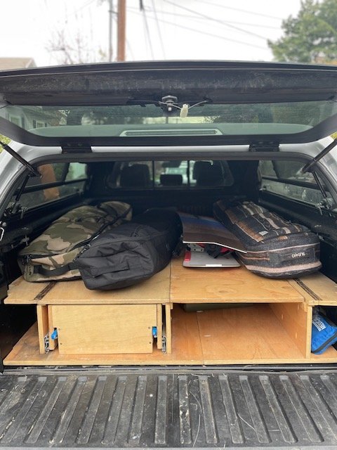

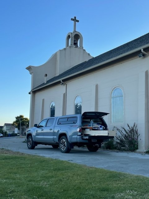

    I was driving on a highway at 70 mph, felt a jolt and noticed a huge white/gray smoke, which turned out to be transmission fluid. After I pulled over at an exit, the truck would start but it would not engage any gear. The car was towed to a Toyota dealership, and they diagnosed that a bolt in a torque converter fell out?? They don't know why it happened. Has this happened to anyone? As a result, I'm getting a new torque converter and transmission for my 2020 Tacoma TRD Sport with 40,000 miles. Luckily it's covered by the warranty. I was told that the engine itself is fine. I'm not sure the flexplate is fine. What do you all think? I do not want to deal with an issue like this after the warranty ends at 60K. I've lost the confidence in the vehicle and I'm thinking about selling this truck after it gets fixed. The pictures were taken last year. Since then it now has a thule roof rack on it for surfboards. The truck is perfect for weekend climbing, snowboard and surfing adventures, but I don't want to get stranded again far from home.
