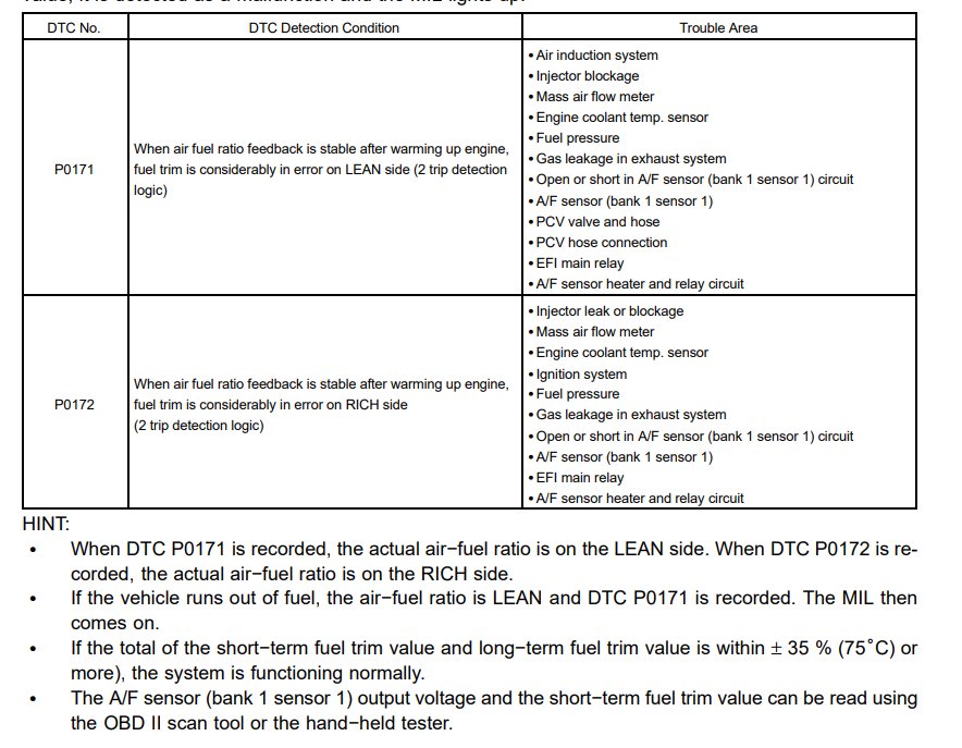

    I cleared that P0171 the other day and it hasn't come back. I had a p0172 for about a week when I first bought her.

    I'm sure you came across it in your research but those two lovely codes (lol) -

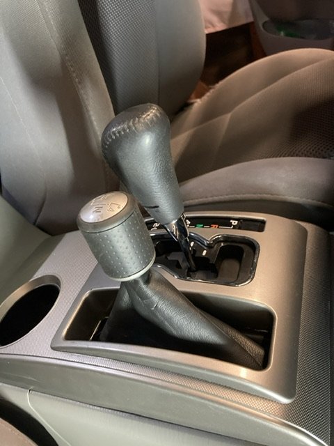

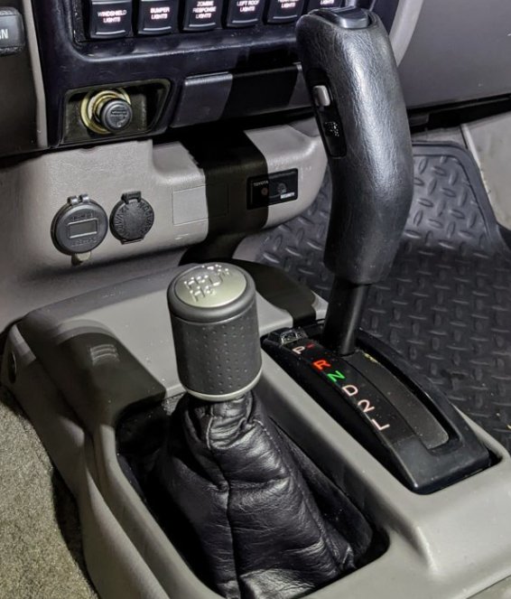

    We share the same good taste in tcase shift handles :rofl:

    Hell yeah :headbang:

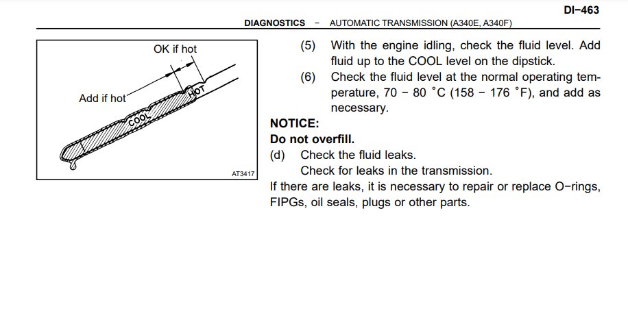

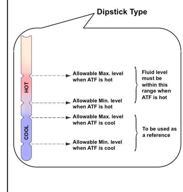

    So just checked fluid and I must have been smoking something when I checked before because it seems way overfilled! Now I’m not sure if I would say it’s cold (drove it about 6 hours ago) but it’s about an inch above the hot mark. Going to get it up to temp and see what it says.

    I edited my earlier post on checking the fluid and added a graphic. Here it is again -
    Definitely don't want it over. I mean a hair over, OK but an inch over on the dipstick? That would bother my OCD. lol

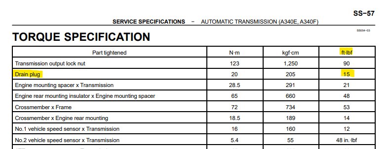

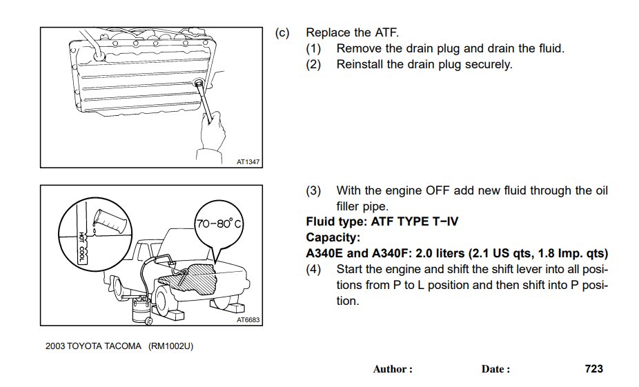

    No need to pull the pan, drain plug it. Will need/should replace the crush washer.
    With a new crush washer (P/N 3517830010), upload_2023-4-12_17-8-52.jpg
