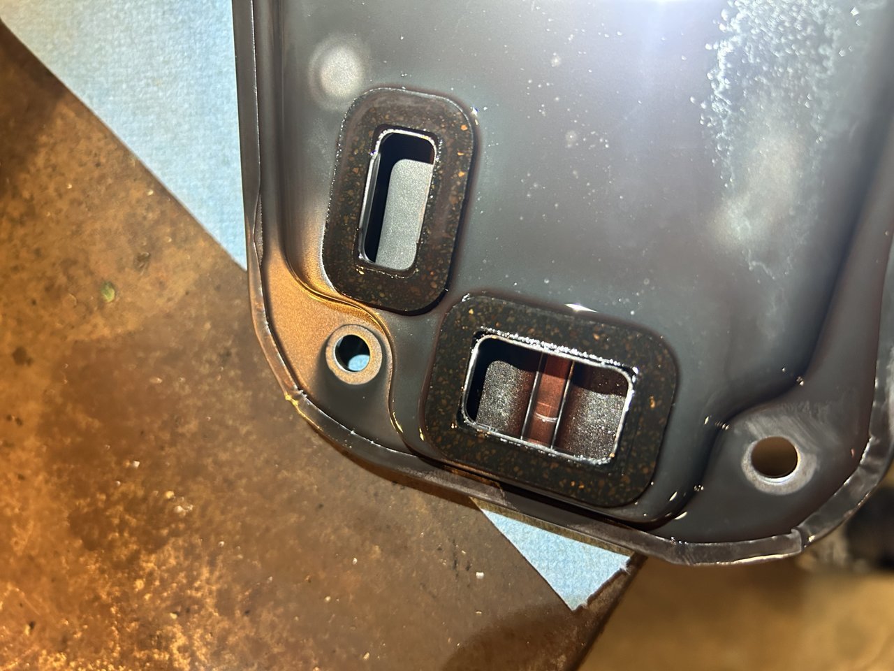

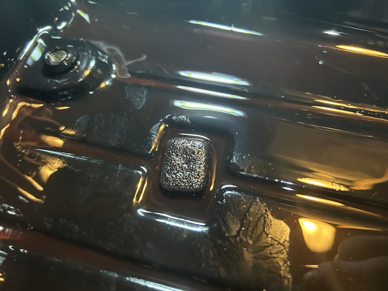

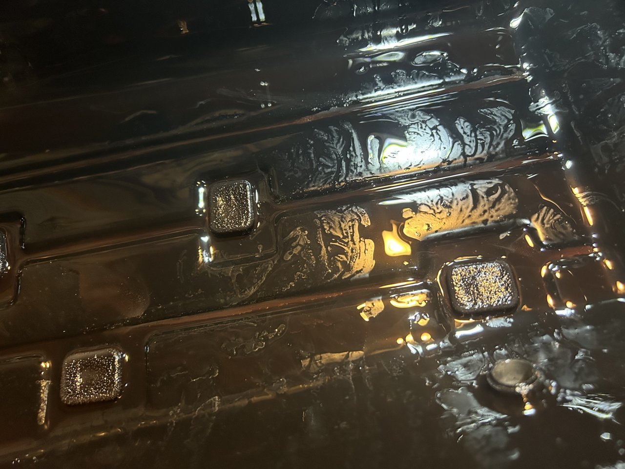

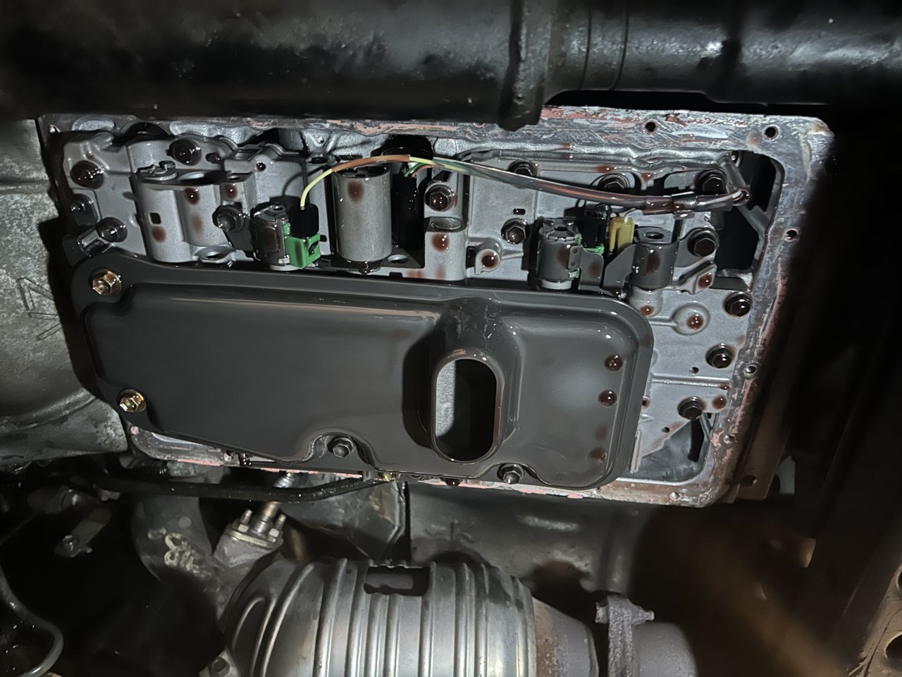

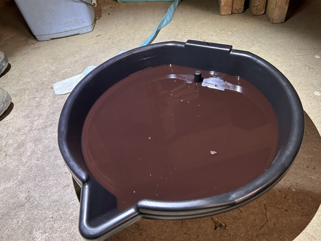

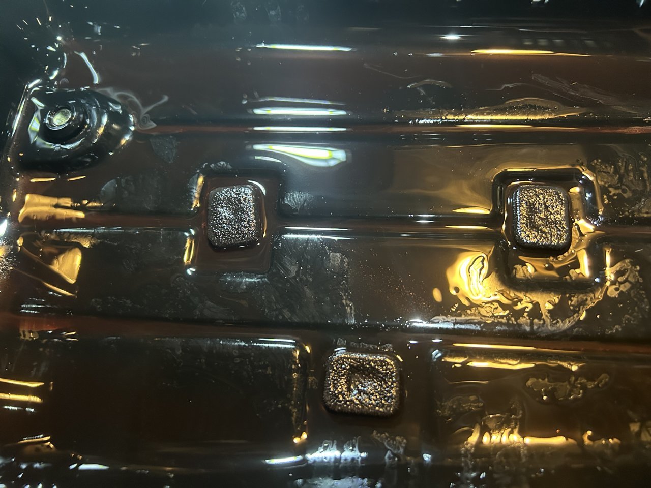

    Finally dropped the pan tonight. Need to pick up an inch pound torque wrench tomorrow so only got this far. Removed old filter and a bit of the gasket. Cleaned up the pan and temporarily put it back on with a few bolts.
    I definitely wouldn’t say it was “Chunky”. However the oil looks pretty nasty and the magnets all had a good bit of very fine metallic sludge on them.
    I don’t know the history (1 owner) before I bought her with 151,000 miles. The “old” filter looks pretty clean so I’m guessing I’m not the first person in here?
    I’ll keep y’all updated as I finish the job. Thanks again for all of your help!

    At least it wasn't black sludge with shiny specks :boink:
    Are you reusing the strainer? If so, make sure it fits snug around the cork 'gaskets' where it mates to the valve body. When I pulled the strainer off this 1999, they were actually rubber not cork and they were brittle and loose. Ended up replacing it.
    I want to say the magnets on this one were about the same. Seeing yours makes me want to drop the pan from my 2002 340E and see what those magnets look like.

    I have new filter. I was afraid what this one was going to look like. It looked pretty good besides a little bit of metallic dust in the most rectangular cork port.
    I plan on doing a few rounds of drain and refills to try to clean up the system a bit. I read flushing higher mileage transmissions may not be a great idea?
    But now I’m even more curious…do you think I have issues beyond the torque converter?

    That metal on your magnets is a representation of whats been floating around in your transmission fluid for a long time . The particles that are collected on the magnets verify a converter bearing issue . Those are the large particles on the magnets . The smaller particles go past the filter
    Considering that metal had to travel through your aluminum valve body and aluminum pump before it ended up on the magnets , is a good indication you can also expect valve body wear and transmission pump wear .
    If you plan to fix this transmission , I would consider a Sonnax valve body kit , fresh valve body gaskets and go through the pump with fresh bushings and sealing rings
    The Sonnax kit installed into the valve body is going to freshen up all your hydraulic circuits that were damaged from the metal travelling through your fluid
    for all those years . Steel particles floating around act like sand paper on those tiny aluminum spool valves inside the valve body
    The price adds up quick mind you.
    The Sonnax kit runs about $ 300 bucks

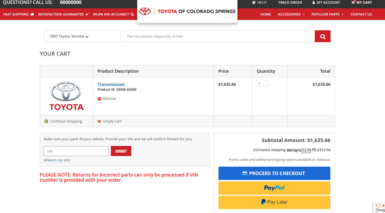

    Would you say that a rebuilt TC is a safe call? I was thinking about just sourcing a new OEM one.
    I was recently quoted 4000-4500 to have my transmission rebuilt with an aftermarket TC. That was here in Lancaster, Pennsylvania.

    Granted this is for a remanufactured Toyota A340F, 6 cyl. That ship amount is to the San Francisco Bay Area (I didn't plug in your zip).
    Personally, if you're going to go that route, I'd just order a toyota reman and roll the dice. I'd feel more confident with that vs a local shop rebuilding mine.
    I still think you should just drive it. If it goes, it goes. Cross that bridge when you get there. At the very least, see how things are once you have it back together.
    I didn't check McGeorge but since you're on the east coast, that's who I'd order from.

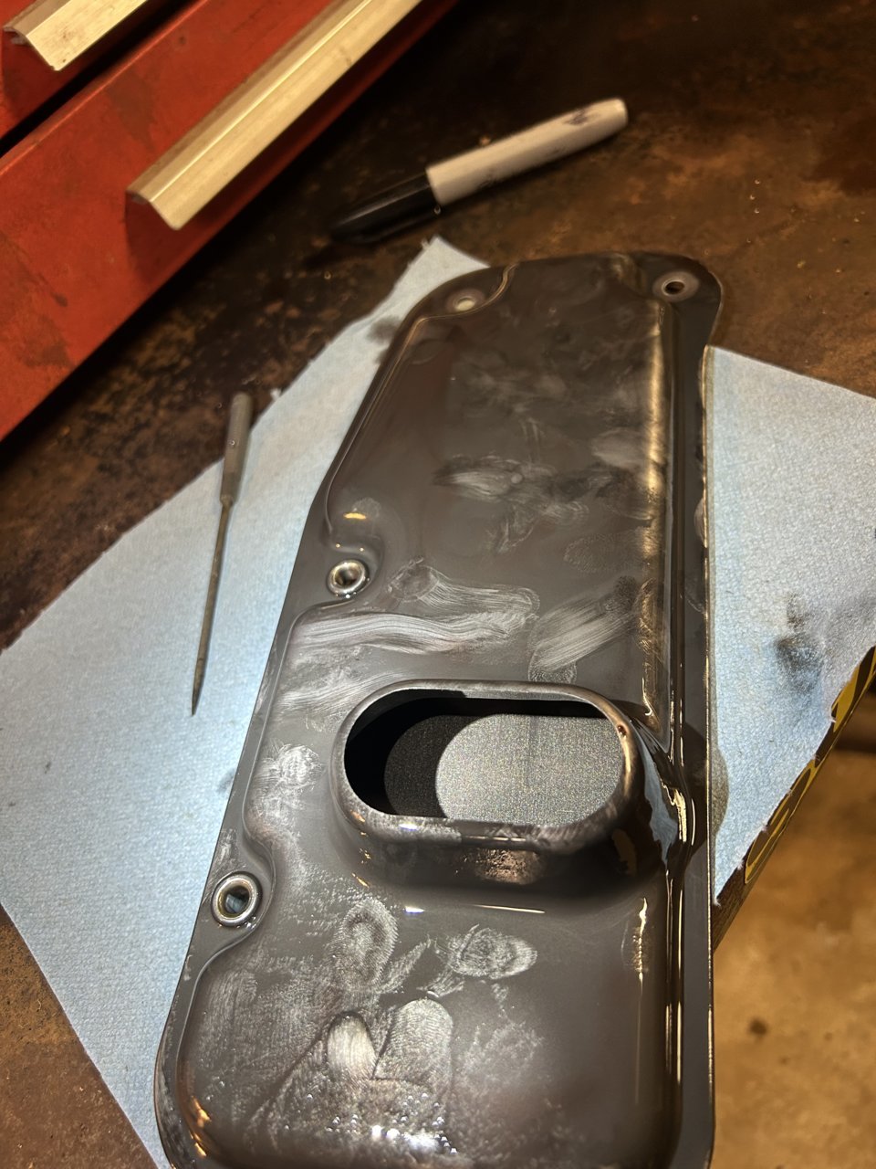

    Hey guys….side question….
    While looking over my notes this morning I realized why you should never assume anything…
    what I ASSUMED was that Toyotas FIPG were all the same. I actually ended up using the 103 FIPG that is used for the camshaft housing. I’m now realizing that is different from the 1281 FIPG that is called for. I know the color should have been a giveaway but I again, assumed maybe it was an updated formula. :facepalm:
    Do you guys think it will be fine? Max Operating temp for FIPG 103 is over 400 so I’m not worried about it getting too hot. Does anyone know what the differences are between these two FIPG ?
    I was letting it cure overnight but haven’t filled yet. If I need to, I might be able to run out and grab some 1281 from a dealership and re do everything….

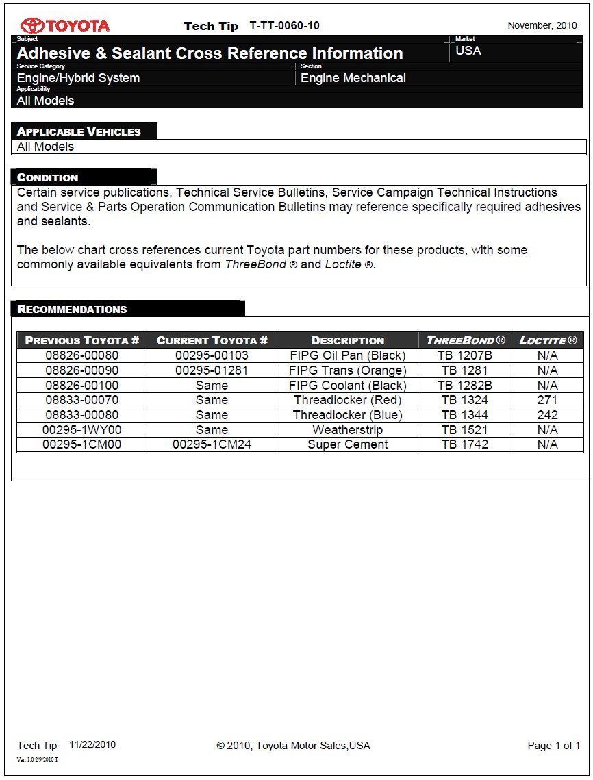

    Need to re-do it. Trans fluid/gear oil will do a number on the black FIPG. Composition is different. Black is specific to engine oil. Definitely need the orange stuff :)
    P/N references -
