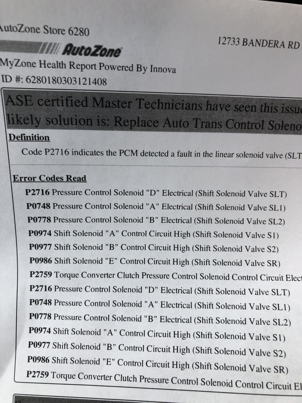

    Doing that now
    On the drive to autozone outside of starting off in what seems like limp mode once it gets going it has no issues accelerating or shifting gears etc
    I was able to go 55 without issie

    This looks to me like it happened when I connected the battery without the tranny installed
    There couldn’t possibly be this many things wrong

    Well , it looks like the ECM did see you remove the wiring harness .
    Thats the reason there are so many codes .
    Did autozone clear them ?
    I think you are going to need a cheap scanner capable of clearing codes to get this critter working propelry .

    Problem solved
    The main ECU harness was not seated fully
    Reseated it and locked it in
    Lights gone and truck drives normally now
