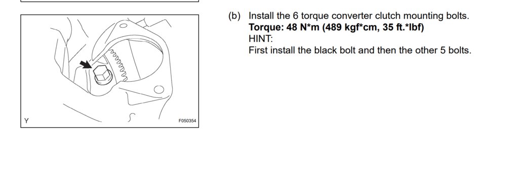

    When you put the new trans in, make sure the black bolt goes in FIRST.
    I'd mark the flexplate where that bolt came from too. Because, well....why not?
