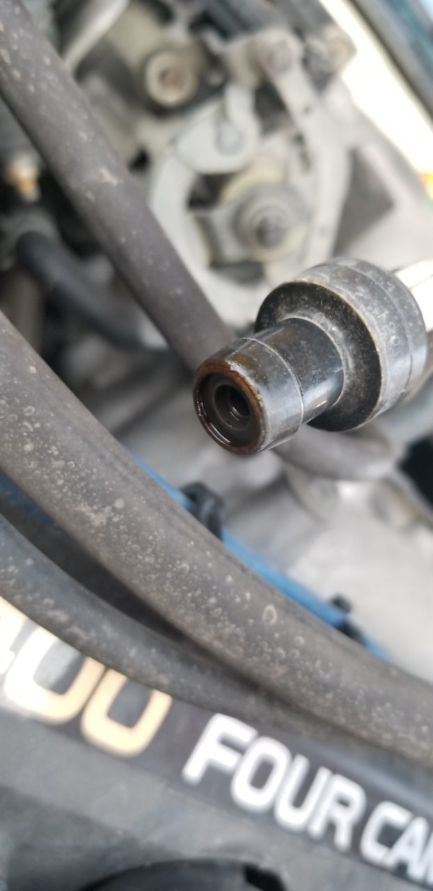

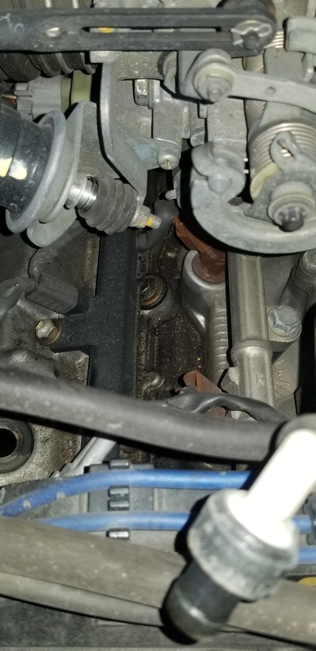

    @2JHilux thank you. When I did the job, the PCV valve was replaced with an OEM unit. The valve hose could use a replacement. I checked the PCV valve and the hoses that were in play, no clogs were detected. I will look into cleaning out the PCV system as you mentioned.
    Here is a photo of the valve, showing the bottom part that plugs into the cover. Any issues with the oil residue?

    I think if it's been replaced and you know what the wetness is around the hose, you're just fine. He just noticed it and brought up a good point about it. But I think as long as the lines are clear and the valve is new, you should be okay there. Unless there's more to it, and there might be. But I'm thinking that's fine

    There will be some oil on the bottom of the PCV which looks normal. If you replaced it on the last job and you checked the hoses I think you are most likely ok.
    The oil residue on the hose is probably from before you changed it then, or look for a split in the bottom of the hose.
    Those hoses usually have an oil mist going through there so oil can come out of places over time.
