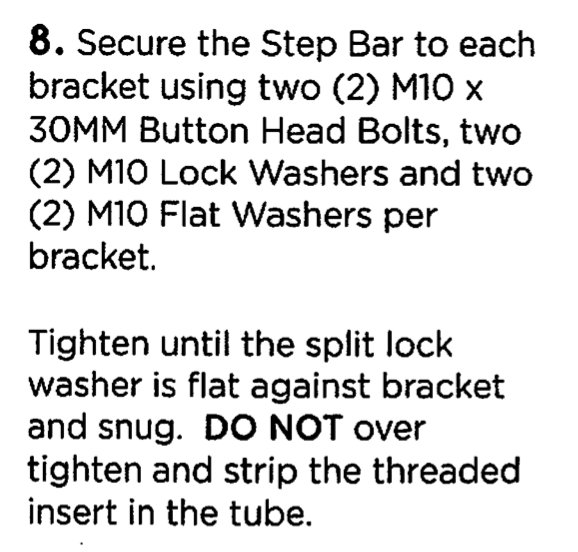

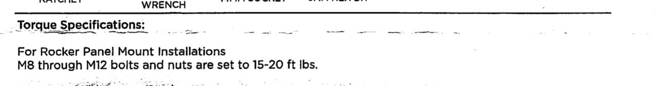

    Honestly, much less. I may not have the same ones that you do but here are two quick snapshots from my instructions. First, do not over tighten. Second, the torque specs.
    Hope that helps ... Just want to save you the frustration I had. ;)

    Yes. I've attached the instructions for your convenience. I got these for $149 on sale because I need the step. They also came in handy getting all the snow off the roof. When I get back to doing what I call light off-roading I will looking into some basic rock sliders. But these have been great for me.
    Hope this helps. Might not be the same model but it goes to show you the torque on those threaded nuts is really low. The instructions actually say "tighten only till the washer flattens" which is pretty easy. Gentle firm but not tight. I am assuming that all of the Ionics have the same approach to the threaded nuts.

    So - the official word from Realtruck on the torque for the 3" gloss black nerf bars for double cab 2021 Tacomas is 15-18 lbs.
    Realtruck seems to be a good company. They're overnighting me a new bracket. They said I could mount the bar with just the front and rear bracket so long as I don't actually stand on it. With this being the passenger side bar, and a new bracket arriving in the next day or so, I'm going for it.
