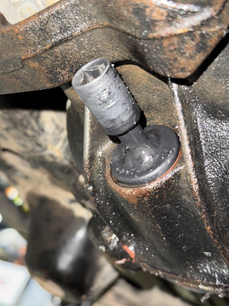

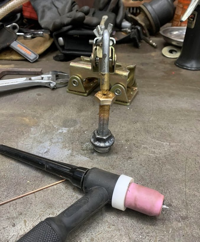

    IMG_7504.jpg Even the Lexus plugs can round off if you’re not careful. I chose the nuclear option and had a buddy weld a 10mm allen socket to the plug.

    Or just weld on a nut like the rest of us.

    mine was a bitch too and i replaced w lexus plug. i got allen seated carefully and then 2 hand sledge whacks to 3/8 wrench i broke it free
    i dont torque drain or fills plugs ever, just snug them up. i tihnk the drain is around 50lb and the fill is like 25 or 28 technically

    That works too, of course. Mine was already stuck in place and I had an extra socket on hand, and knew the inserted allen key would already be centered on the plug.
