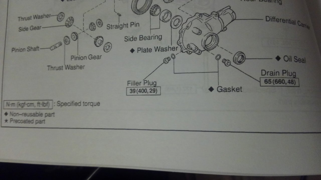

    Have searched pretty heavy, all info seems to be on newer gens.
    Looking for recommended toque specs for my front differential drain and fill plug (1995.5 Tacoma. 3RZ).
    Fyi, my truck has the two different hex sizes: 12 mm (drain) and 10mm (fill)
    Cheers!!!!

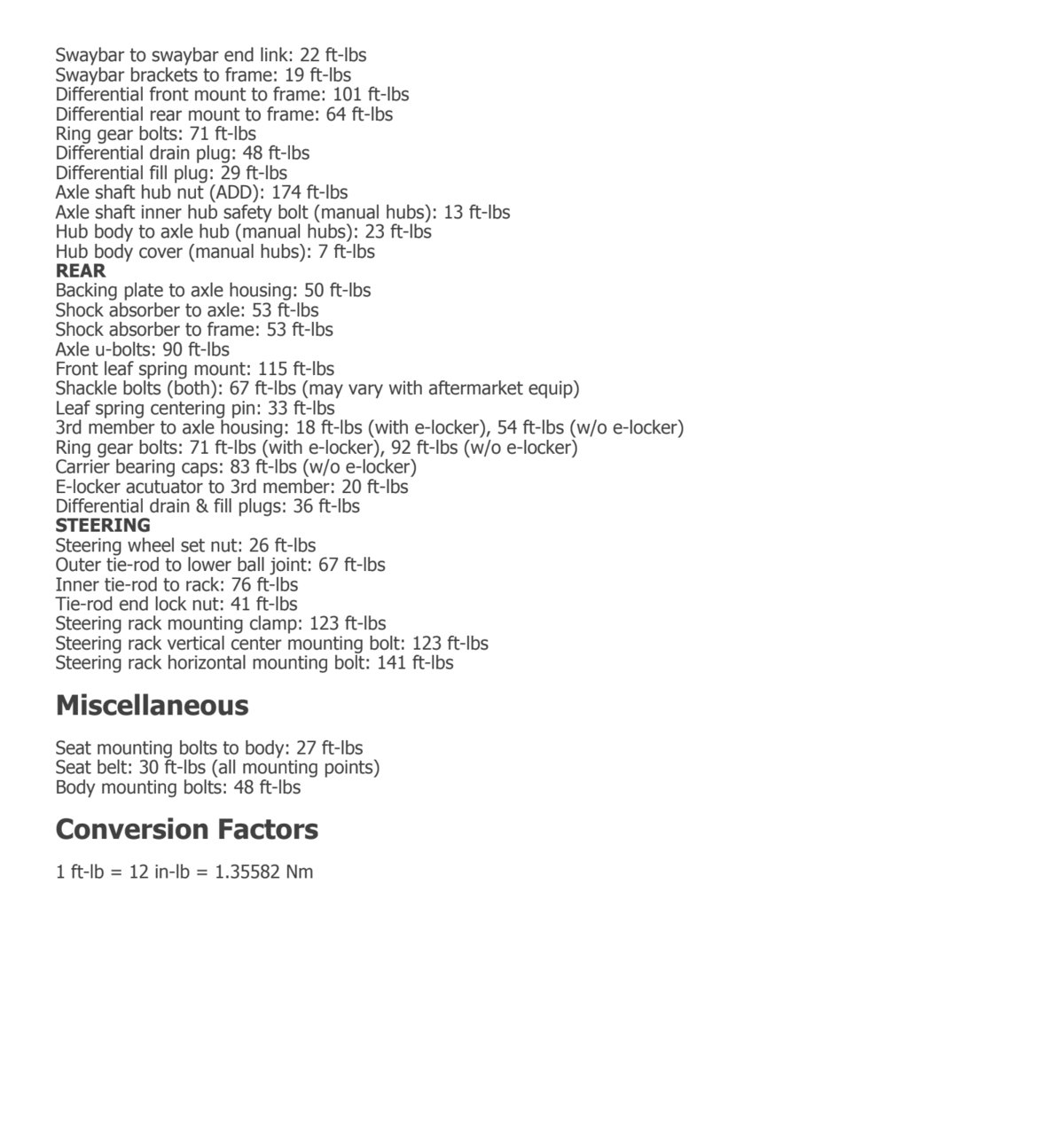

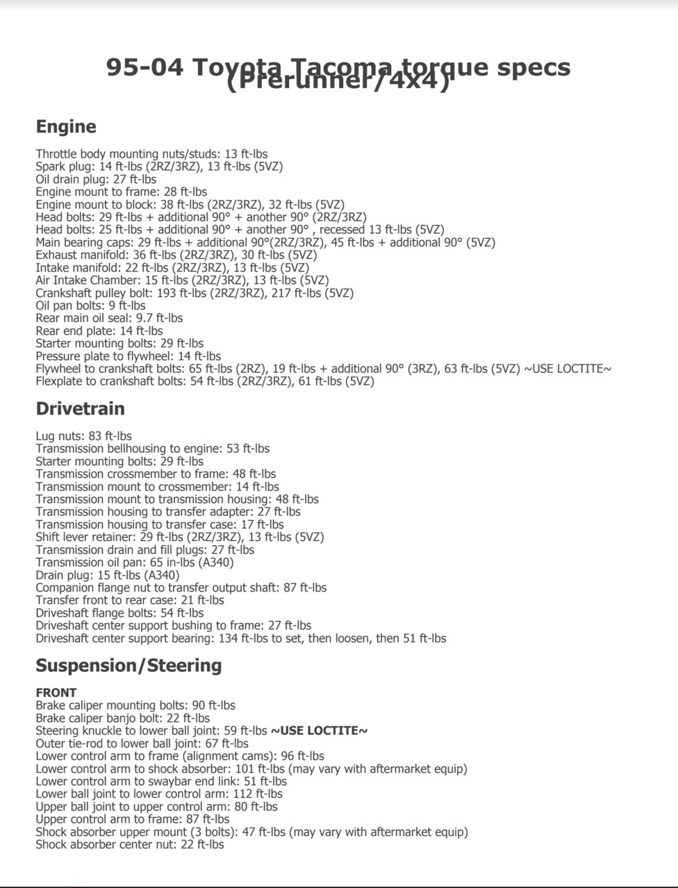

    Front diff drain plug is 48 ft/lbs
    Front diff fill plug is 29 ft/lbs
    For future reference -

    Is there a link you could provide to that torque spec compilation? Cheers!
