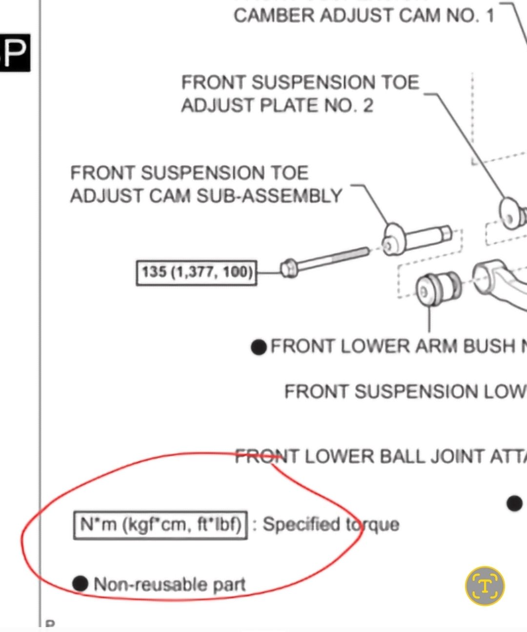

    OP,
    From the service manual PDF, page 225

    2015 DCLB
    He's asking about the 3 different specs that appear in the manual, it can be a bit confusing
    N*m = Newtons (per) meter
    kgf*cm = kilogram(s) force (per) centimeter
    ft*lbf = foot pounds force (per) feet
    Most torque wrenches have options for lb/ft and N*m. Just use the regular lb/ft setting, the 2nd number in parenthesis
