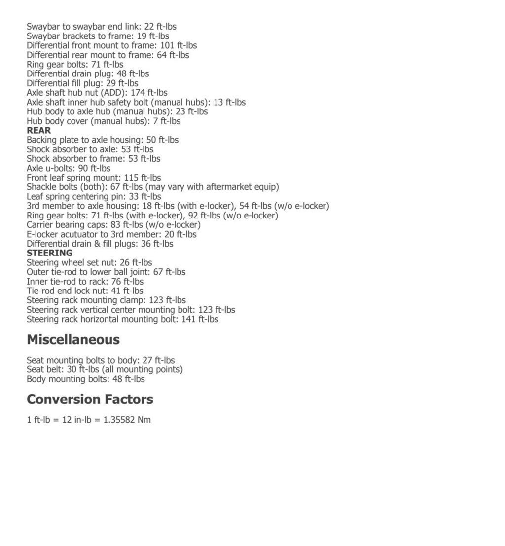

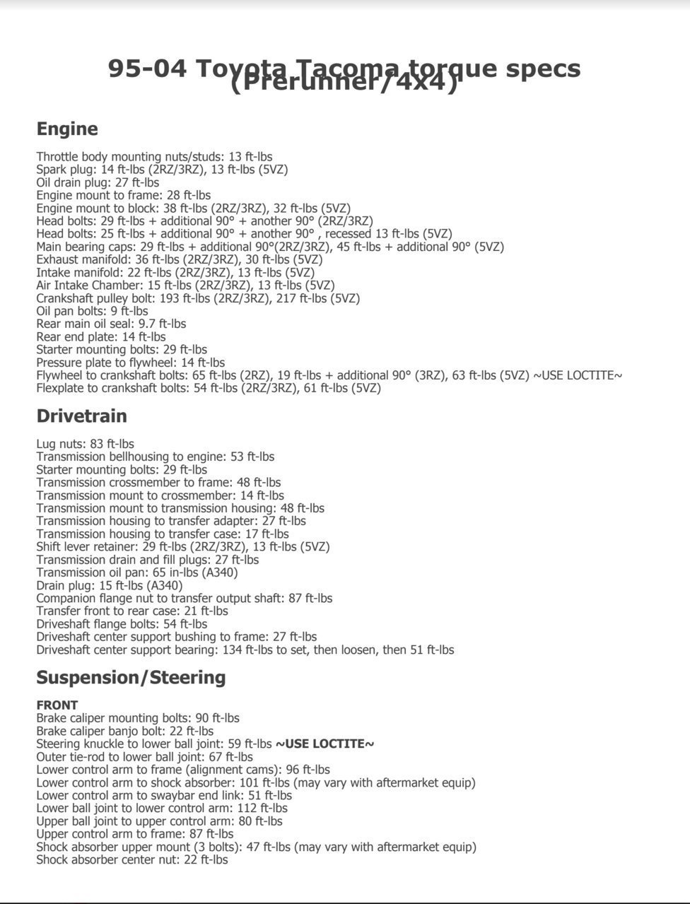

    Someone fortunately bumped up an old post; it's in the factory service manual that's downloadable anyway -
    Front Suspension Torque Settings
    ABS Speed sensor & Wire Harness................................................. 71 in lbs
    Stabilizer Bar Side (2WD)...............................................................22 ft lb
    stabilizer bar lower arm (Hex end to hold it) (both ends of 4WD)....66 ft lbs
    Stabilizer Bar Bracket (4WD).........................................................19 ft lbs
    Upper Ball Joint.............................................................................80 ft lbs
    Upper Control Arm........................................................................87 ft lbs
    Front/Rear Alignment Shims (2WD)...............................................94 ft lbs
    2WD Upper Ball Joint Mount (4 bolts)........................................29 ft lbs
    Lower Ball Joint Castle Nut.............................................................103 ft lbs
    Lower Ball Joint Mount (4 bolts).....................................................59 ft lbs
    LCA Cam Bolts..............................................................................96 ft lbs
    LCA Spring Bumpers......................................................................17 ft lbs
    Outer Tie Rod End (Castle Nut)......................................................67 ft lbs
    Strut (Bottom mount)..................................................................101 ft lbs
    Strup Top Hat...............................................................................47 ft lbs
