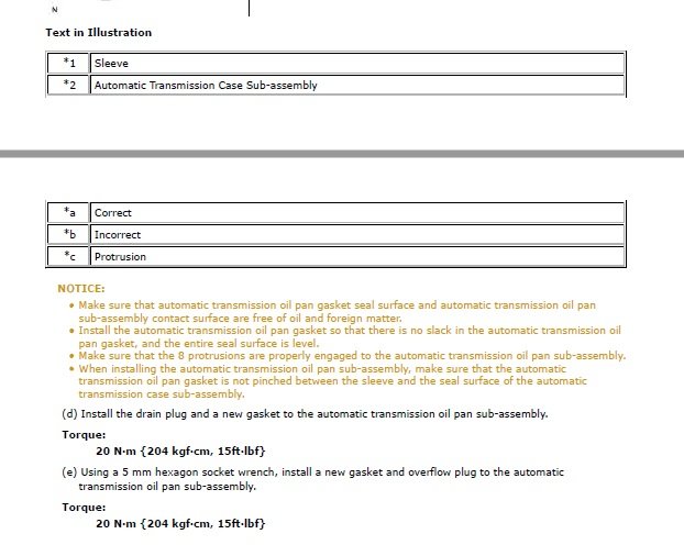

    Anybody have a reference for the torque specs for the transmission pan bolts?
