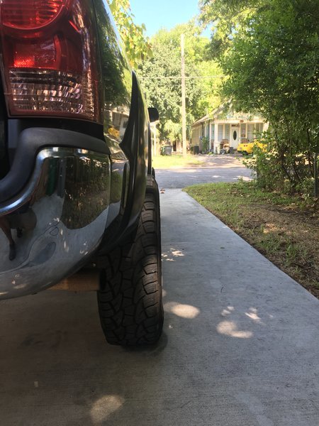

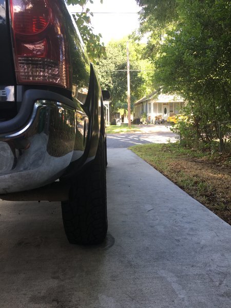

    So, just installed some spidertrax 1.25 spacers I picked up from another member here. Post:image.jpg Pre:image.jpg
    Most people won't even be able to tell. But I like it. Anyway, for some reason, I remembered the torque spec for the lugs to be 90lb/ft. A few days after the install, I looked it up and spidertrax specs are only 75 lb/ft of torque. Question is, do I need to go back and loosen the lugs? I have no experience with these and absolutely don't want any problems or mishaps. Thanks in advance....
