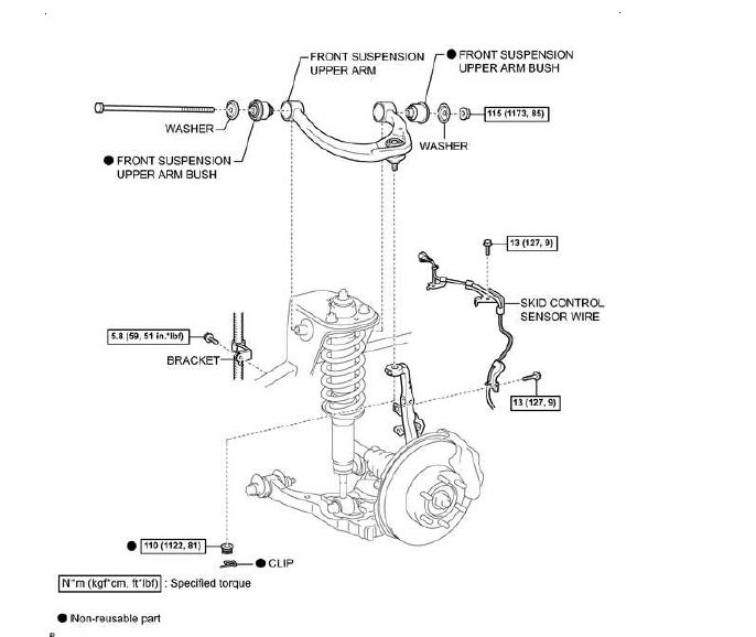

    I searched but only came up with info for the 2nd Gen. Is there a consolidated resource for 3rd Gen torque specs? Or do they apply pretty much the same in the front/rear suspension?
    I specifically need the sway bar, LCA nuts, lower ball joint bolts, lower shock mount bolt, rear shock bolt, rear U-bolt, and the top shock mount bolts....yes I’m installing a 1” top plate spacer and a 1” rear block.:)
