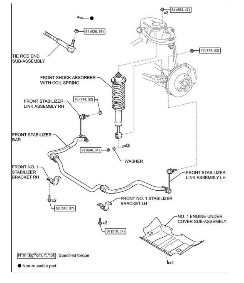

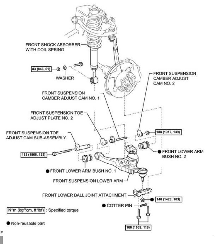

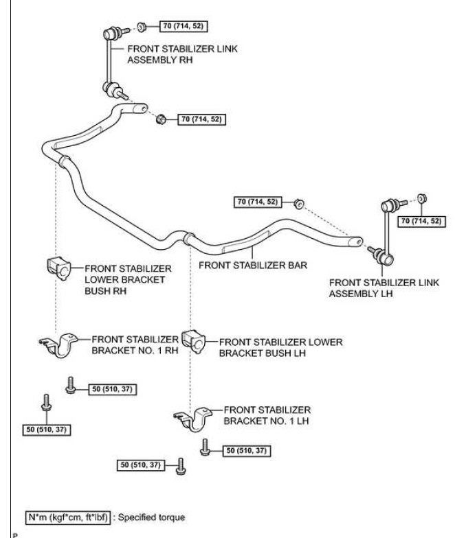

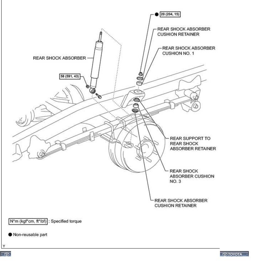

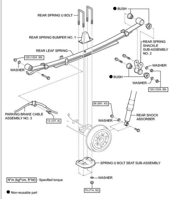

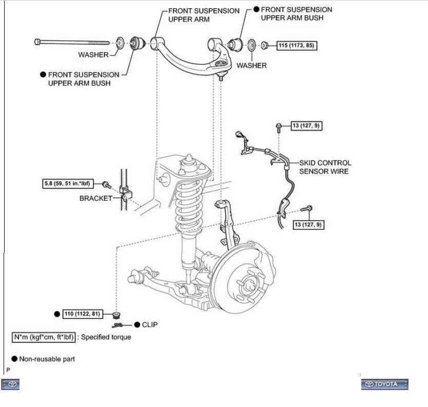

    Im installing coil overs and an AAL tomorrow.
    Anyone have a handy torque spec sheet for what I’ll need to re tourque the individual components back too?

    splitbolt......thanks for posting these.......getting ready to do my suspension swap once the weather turns for the good!!!
    Assuming 3rd gen. values??

    Yes, 3rd gen.
