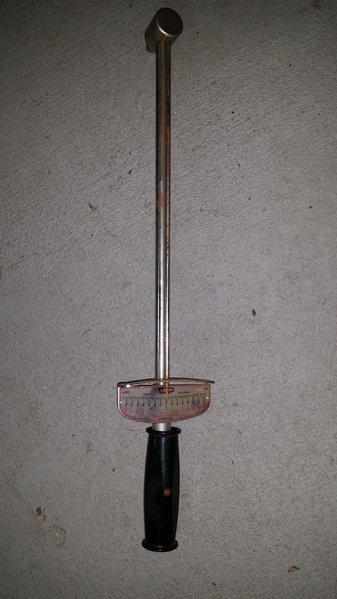

    Having read so many posts on this forum about getting the torque correct on seating nuts and bolts on the Tacoma, I started thinking about my old (30 years, maybe) beam style Craftsman torque wrench (3/8") that was probably at the bottom of their line of torque wrenches when I bought it way back when.
    While I don't plan to do much mechanical work on my TRD Sport (lack of interest, patience, and ability), I can see a time when I might want to check the tightness of various nuts and bolts. I also will do some occasional and minor mechanical work on my motorcycle.
    Without anything to compare it to, I wonder if my old Craftsman is reliable enough for getting the torque settings correct? Should I compare my Craftsman with someone's better quality torque wrench? Should I just buy a better one? I don't want to spend a lot of money on this, given the relative lightness of use it will receive.

    Deflection beam torque wrenches are the most accurate you can buy. They are not the most maneuverable in tight spaces though. I use the ratchet type for lug nuts and suspension components, among other things. I used my deflection beams for engine rebuilds. I own two Craftsman ratchet types and I really do not like them. I would go with a Snap On/Blue Point or something comparable. Get your wallet ready $$$.
