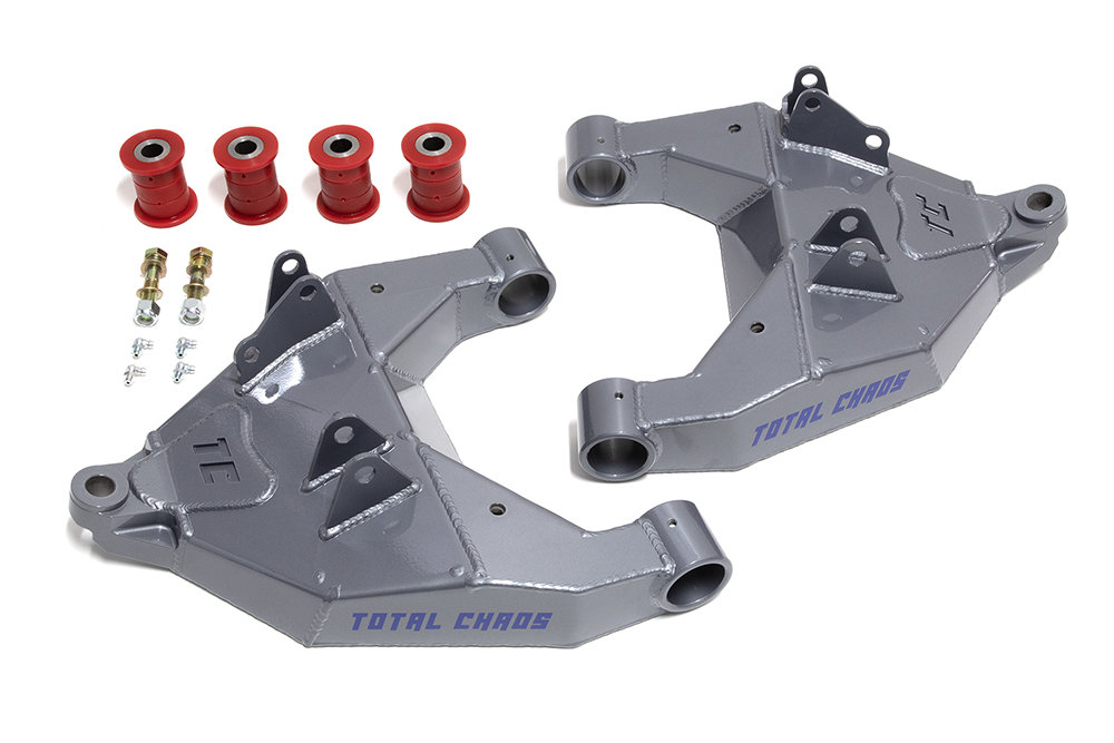

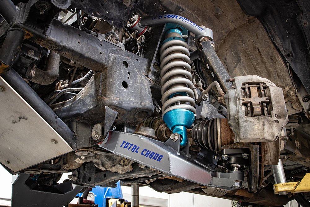

    Finally a replacement LCA from TOTAL CHAOS that features urethane bushings and a secondary tab for dual shock capability. Want to retain you sway-bar? no problem! The secondary shock tab allows you to reinstall your sway bar for better cornering stability when not installing dual 2.5-inch shocks.
    https://www.chaosfab.com/product/19...eries-Stock-Length-Lower-Control-Arms-96555-E
    Maximize the upgrade by adding the TOTAL CHAOS lower ball joint uniball conversion. Will work with stock ball joints.
    Stock length heim tie-rod upgrade COMING SOON!
    https://www.chaosfab.com/product/1996-2004-Toyota-Tacoma-Lower-Uniball-Conversion-OE-Tie-Rod

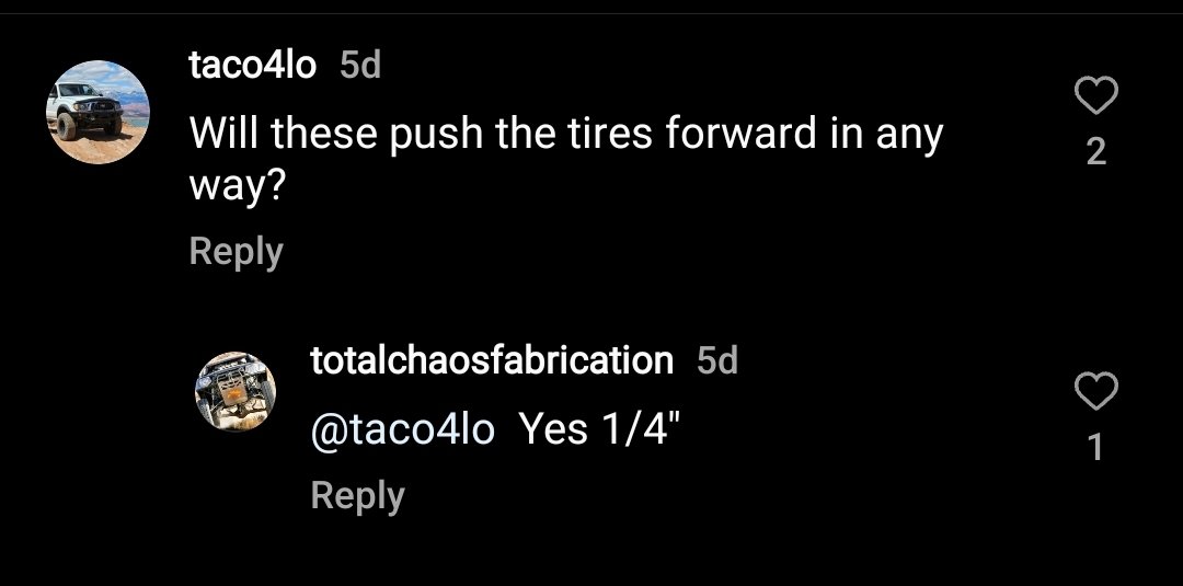

    Saw on their IG that it pushes forward 1/4".

    It wasn't technically announced since someone on the comments asked. Haha

    Yes the arm moves it 1/4-3/8". The reason we kept it this way was to retain factory alignment specs.
