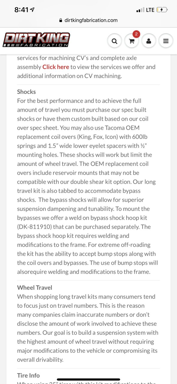

    I currently have stock length race series lowers and uppers with king extended travel shocks. I wanna upgrade to the 3.5 long travel kit. My question is can I temporarily use my extended travel shocks, I know it will limit my travel until I can sell my old stuff to buy new shocks? I know the dirt king kit says I can use them with there kit. But I wanna stay true to total chaos. I enjoyed the installation of the previous stuff I’ve bought

    @TylerH91 the description specifically says the extended shocks won't work. I don't have intimate details on why. Just passing along in case you missed that point in the OP.

    I saw that, and know what it is implying. Just was curious if it will limit it to the point where it won’t work. If I lose 3-4 in of travel just so I can drive it and flip these arms to get some money to buy the new shocks and sell these ones lol it’s a process. Was trying to avoid dropping 5k on suspension when I have some stuff already

    I wanted the intimate details as to why!? It’s not permanent but it’s just something I was considering. If not I’ll just get the dirt king kit cause they have the intimate details lol
