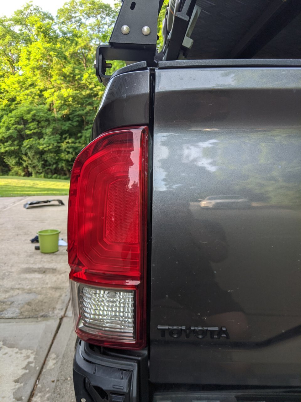

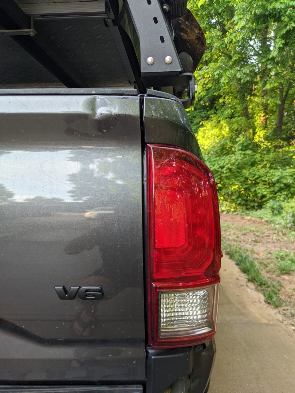

    I've had a GFC camper on my truck for a couple years and I've noticed that the gap was widening at the top of the tailgate. I haven't had any issues closing the tailgate but I got the total chaos bed stiffeners hoping that it would close that gap but it's still there. This picture is with the stiffeners on. Hopefully they prevent future issues from getting worse but I thought I read where others put these on and it pulled the bed sides in square.

    I'll just chime in here quickly. My viewpoint comes as a structural engineer, so take that as you will.
    If you ever carry any sort of weight on the bedrails of your truck (most common example is a soft shell RTT on any rack/bars that mount to the tops of the bedsides), then you most definitely need a set of bed stiffeners.
    Loads that terminate at the bottom of the bed, i.e. a heavy load of dirt/mulch/stone, do not stress the area that the bed stiffeners reinforce.
    It is not a design flaw by Toyota in any sense of the word. The issue arises out of the fact that some of us use our Tacomas in ways that are outside of the scope of their design, again, by affixing mass to the top of the bedsides. That would be like saying that the drill bit designed for wood is a crappy product because it couldn't even drill a single hole through a piece of 3/16" steel plate. It's being used outside of its capabilities, but that doesn't make it a crappy bit.
    Spend enough time around folks who use Tacomas on bumpy roads to haul around RTT's and you will undoubtedly come across uneven tailgate gaps, as the bedsides will move/distort over time.
