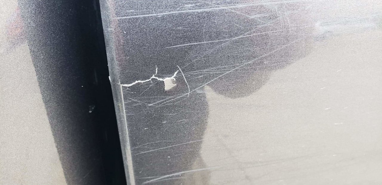

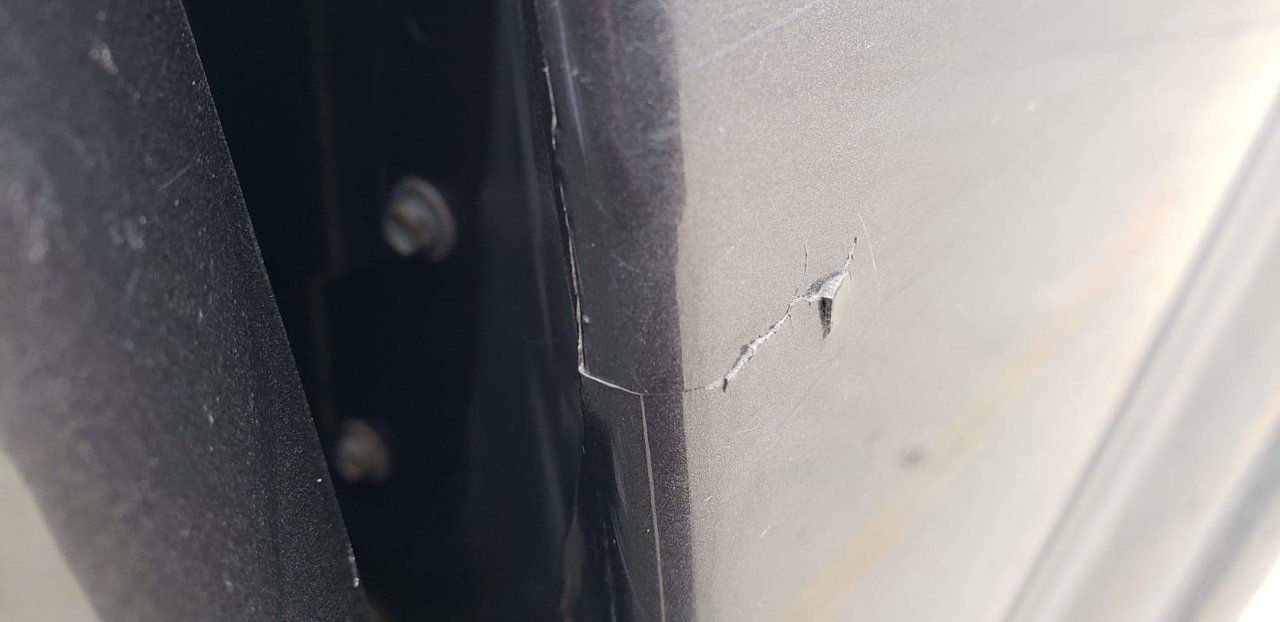

    Two Taco friends of mine have had bed damage from large racks and root top tents. They've had the typical rear bedside issues, and additionally had damage to the front bed corners.

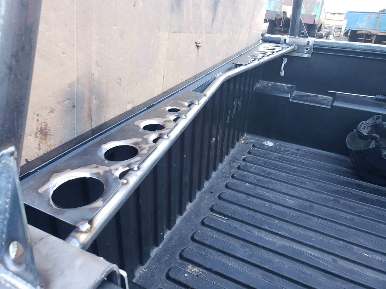

    I built these for the grey taco after seeing the carnage, and there has been no additional damage to the front bed corners.

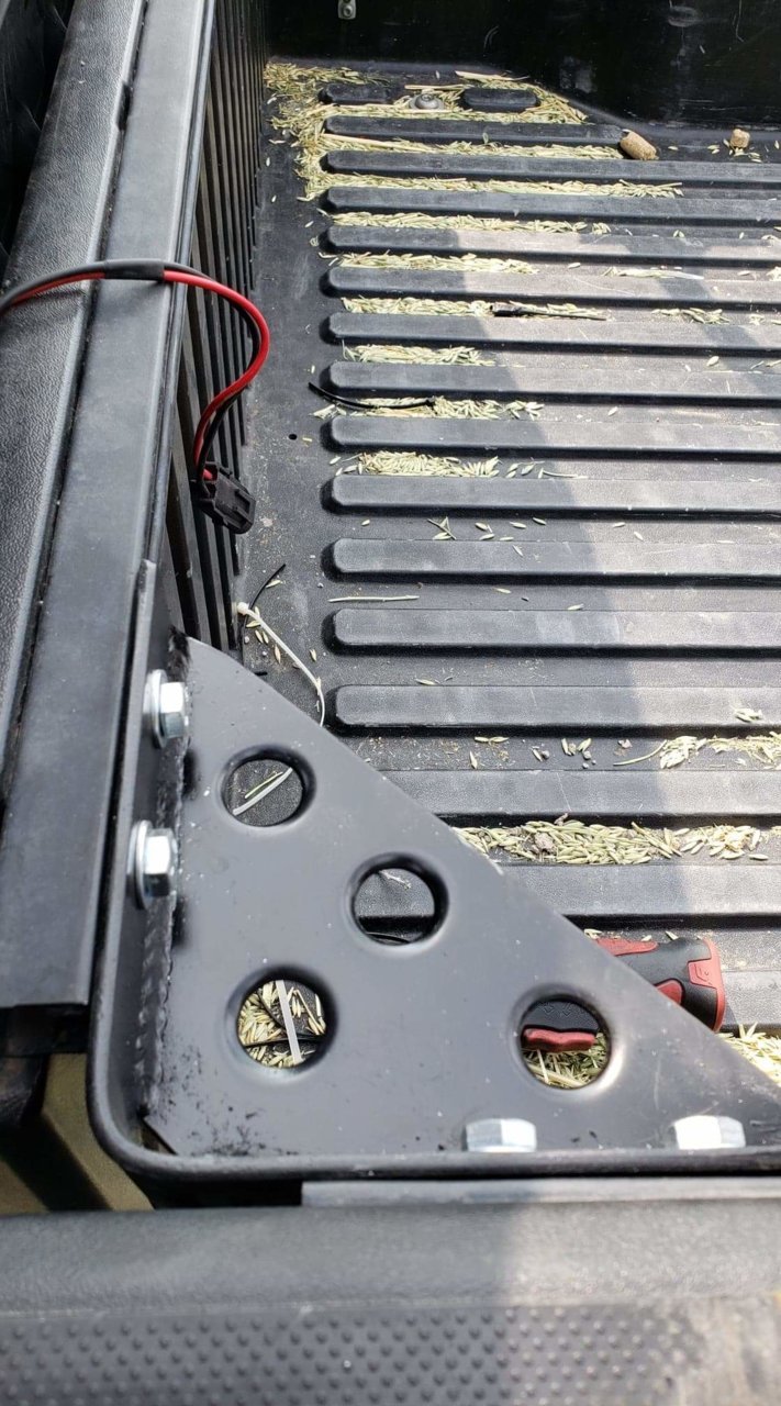

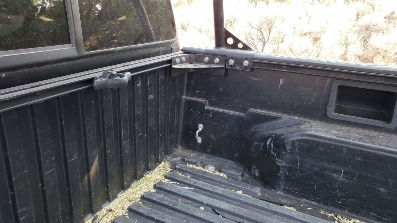

    I built this one for another friend to go with his bed rack
    Recently I designed and built these with the same goal in mind, but to also look good, and offer a few additional features like a cup holder, antenna mount, and additional tie down points, and the ability to pretension the bed, or help pull it back into alignment if needed.
