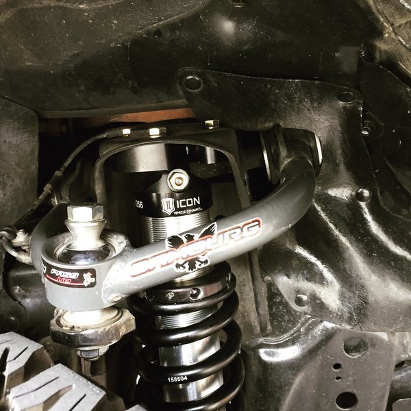

    We are launching a new website soon so there are a lot of products not up yet.
    Retail - $899
    TW Discount - $836

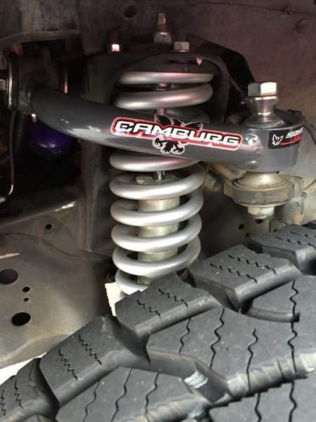

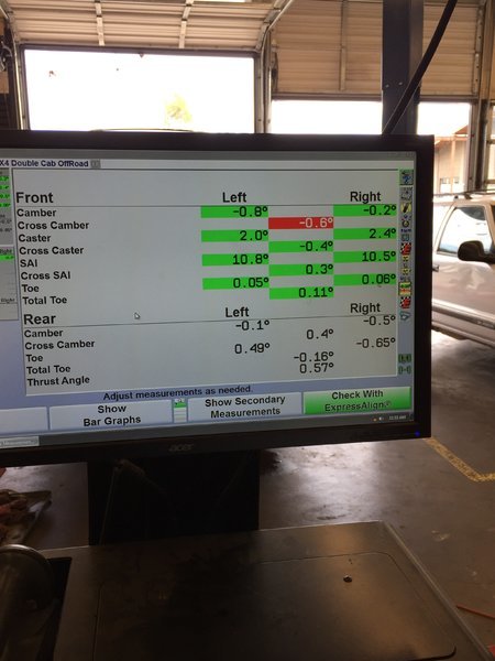

    I've had my Camburg UCA's for about 3 years and have had no problems with them whatsoever. As long as you grease the bushings & spray dry Teflon lube on them you're good to go. As for alignment, here is my latest specs w/ ICON Ext. travel CO's. As for the red at the top, my shop teacher at the college said that is still within specs. We spent about an hour aligning my truck as it was way out of alignment. I also put too much preload as you can see in that picture so I took some off and the truck rides so much better now. And here are my UCA's w/ my previous Bilstein/Eibach lift.
