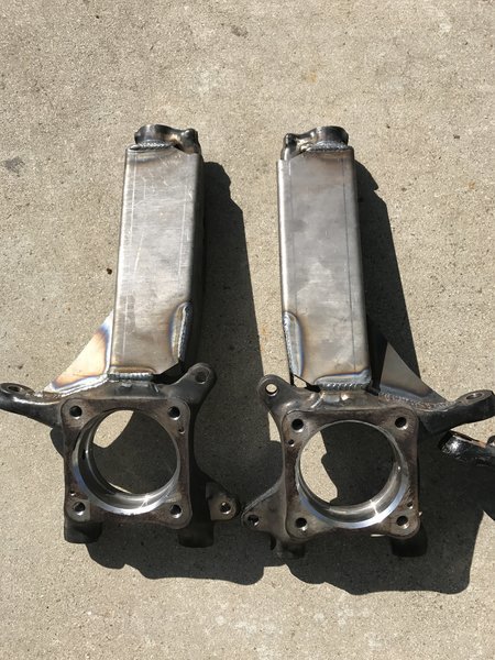

    Another set headed out

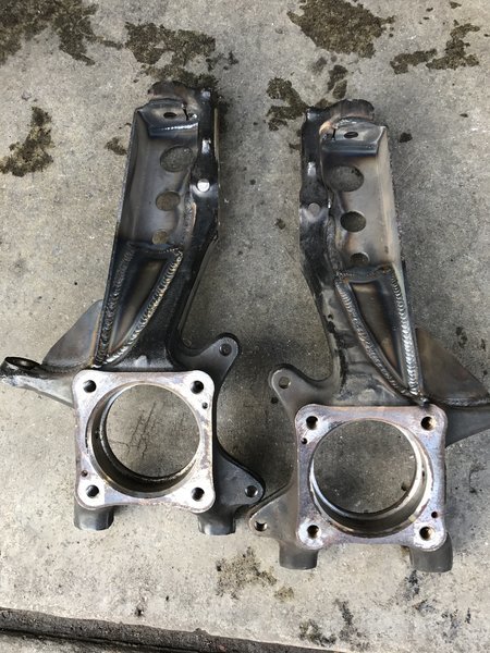

    A set of sway bar gusseted spindles added to my stock, ready to ship out.

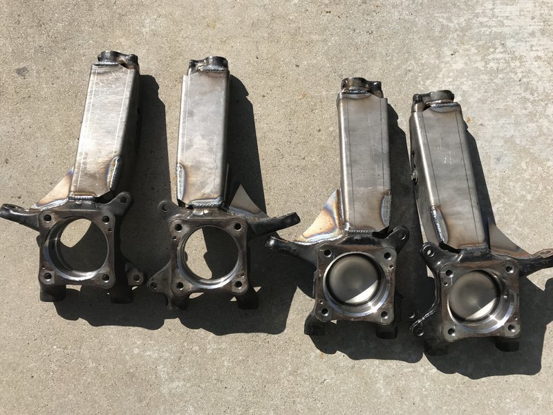

    Two more sets of spindles that were sent out Saturday

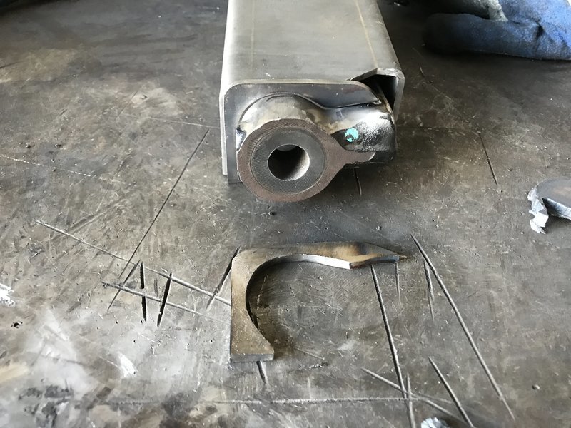

    I do all the different style gussets the same. The top gusset is a tundra spindle, followed by a non swaybar tacoma, and a swaybar tacoma

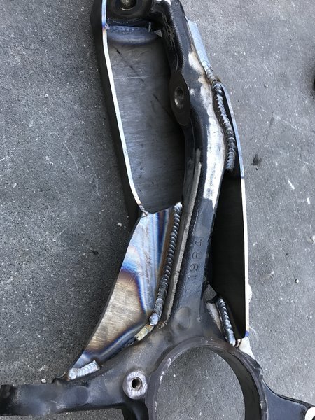

    I also only offer the non sway bar gussets with the tie rod gusset(which I've added to every set I've done) and now the new gusset at the bottom where the gusset meets the spindle. I won't do that style without the added gussets. I feel that the non swaybar gusset without atleast the tie rod gusset is a liability and should not be used prior to addressing its issues. Catastrophic spindle failure on the road could cost someone their their life.
    This is the newest version of the non-swaybar gusset that I build
    I still recommend that everyone goes with the swaybar version of the gussets. Short of if you never plan on running aftermarket wheels I see no reason anyone should run the non-swaybar gussets. Tc's newest gussets are a much stronger design.

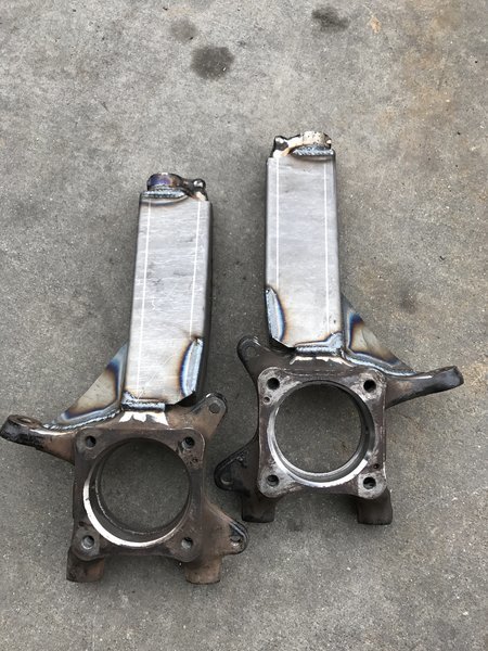

    I set these spindles up special for @Jks1. These are setup to allow him to run balljoint uca's

    Thats good to know that the gussets have to be modified if you run a ball joint UCA. Once I get my lift together I now have a way of getting them!

    Very good to know, wasn't aware of the gussets changing the format of the spindles. Are you willing to continue to do this for those of us who need it?
