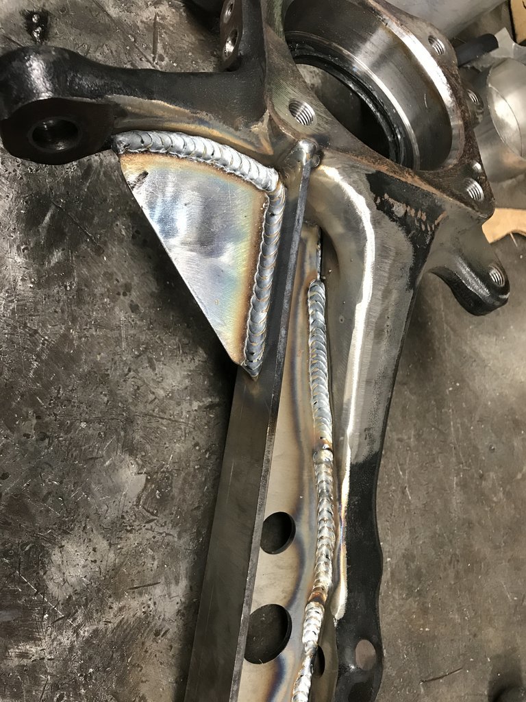

    Your welding skills are def much, much better than mine. So I want to ask you some questions about welding these. I assume I need to pre heat the spindle and bounce around on the weld kind of like stitch weld to distribute the heat load, or can I continuously weld by my welders duty cycle? Also after welding is complete, I think I would need to toss these in some 5gal buckets full of sand to slow the cooling. Also, how much power are you using on your welder? I've got a Millermatic 35 blackface that I'm going to use .035 wire. I think the 4 or 5 slot out of the 6 should be hot enough. Any other suggestions, tips, or tricks would be greatly appreciated.

    You do need to preheat. I jump around but mostly just out of habit. With the preheat some guys like to weld it all at once. I use a fixture when I'm welding everything so I'm not overly worried about anything warping. But I've done them without a fixture and not had any problems.
    I have 3 different welders I go back and forth between. A millermatic 180, millermatic 220, and a millermatic 212. All have different settings. I set all my welders up by feel and adjust them accordingly. I stopped running .035 a long time ago so my welders are setup to run .023 and .030. I'm not very familiar with the tap changes on the millermatic 35 but your voltage and amperage will rely heavily on your travel speed. I run a slower travel speed than most and don't do any fancy puddle manipulations. Your best bet will be to find a way to move your torch that you can consistently do. As far as setting go. I adjust till the wire flows smooth and the toes flow in on the outsides of the weld. My heat setting are more than likely slower than most but that is made up for by my slower travel speed.
    Sorry if this is confusing it hard to type out something you've kind of just refined over the last dozen or so years into a coherent paragraph. All my adjustments are made based on watching my puddle flow thru the hood. I don't do too much adjusting based on what the weld looks like after it cools.

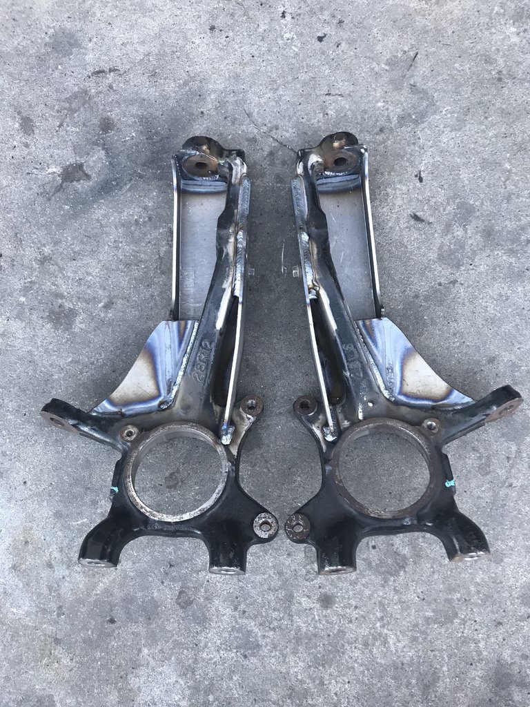

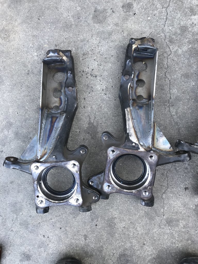

    Bunch of sets of spindles headed hour this week. This set has been set up for balljoint uca's

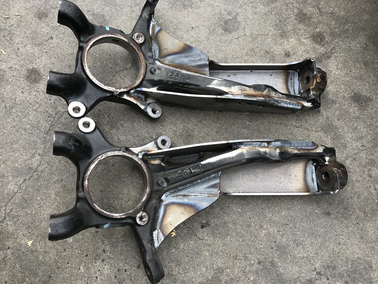

    Another set of spindles headed out

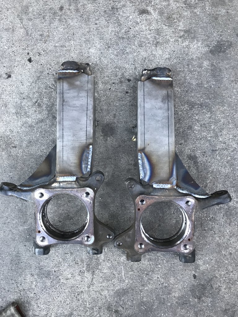

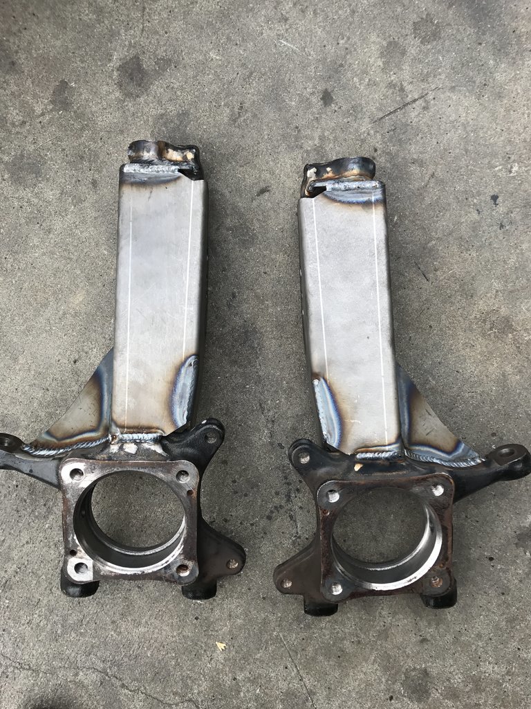

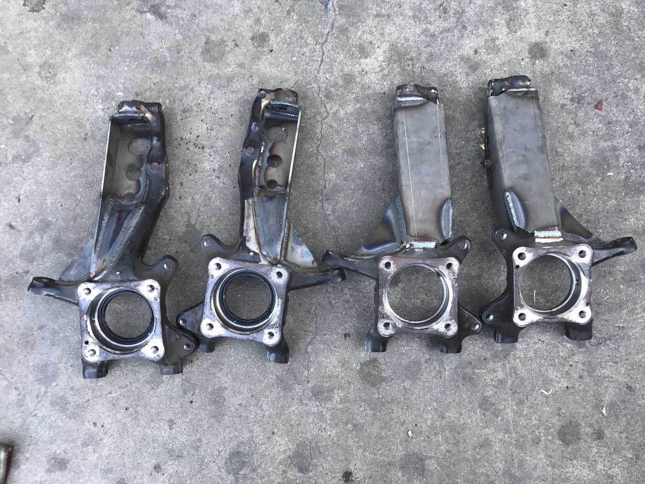

    A few more sets of spindles that got welded up over the weekend
