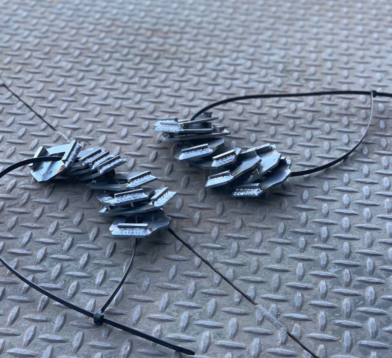

    Got a set done this past weekend along with cam tab gussets for a 4Runner.

    Those turned out great.

    Thank you, 6th set of spindle gusset I've done so far.
