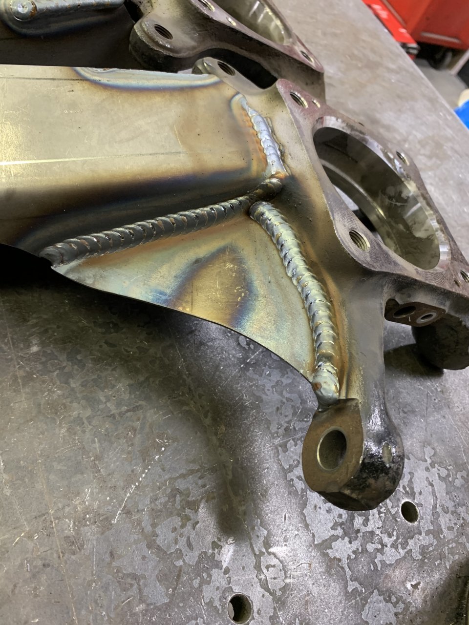

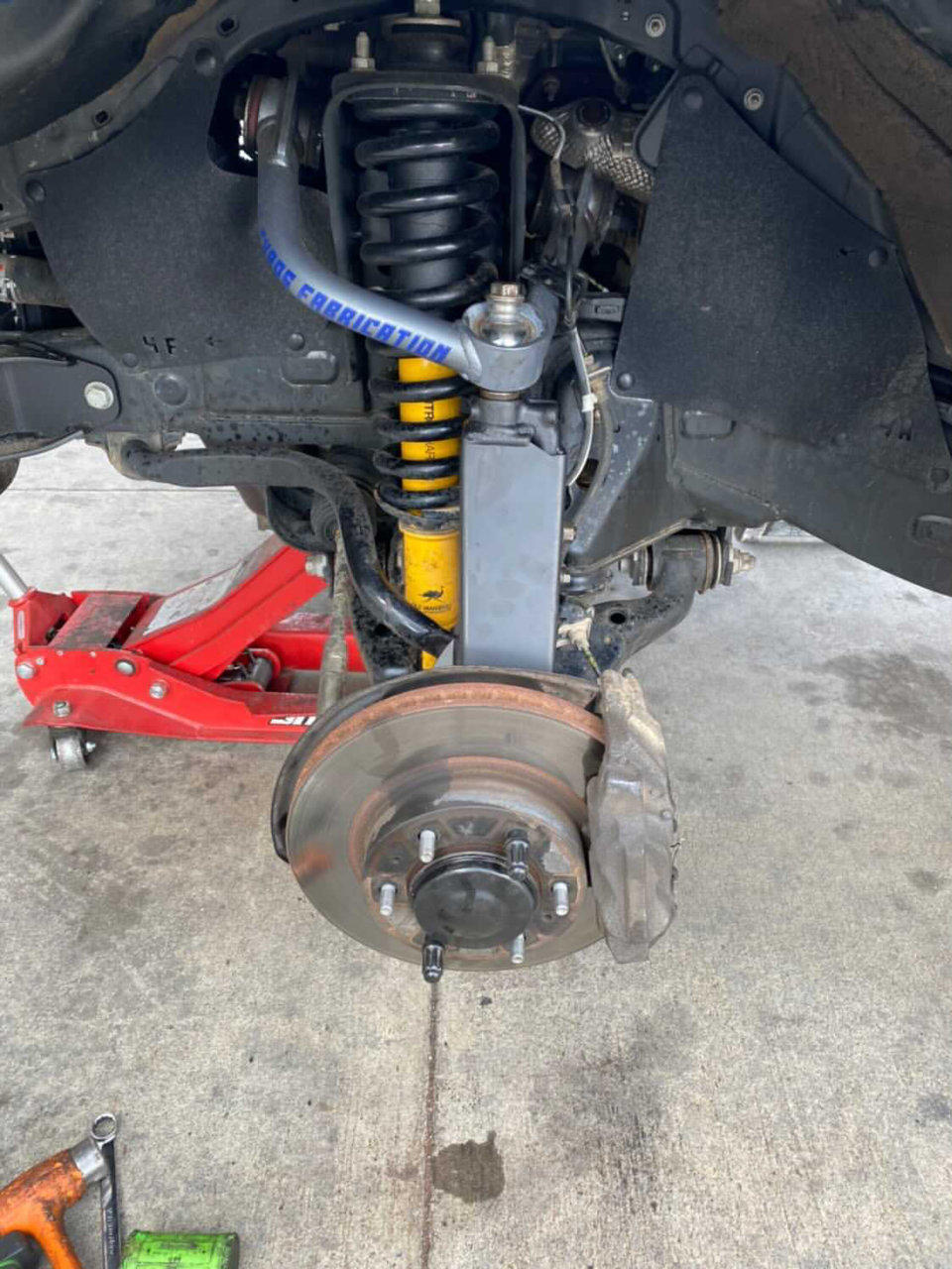

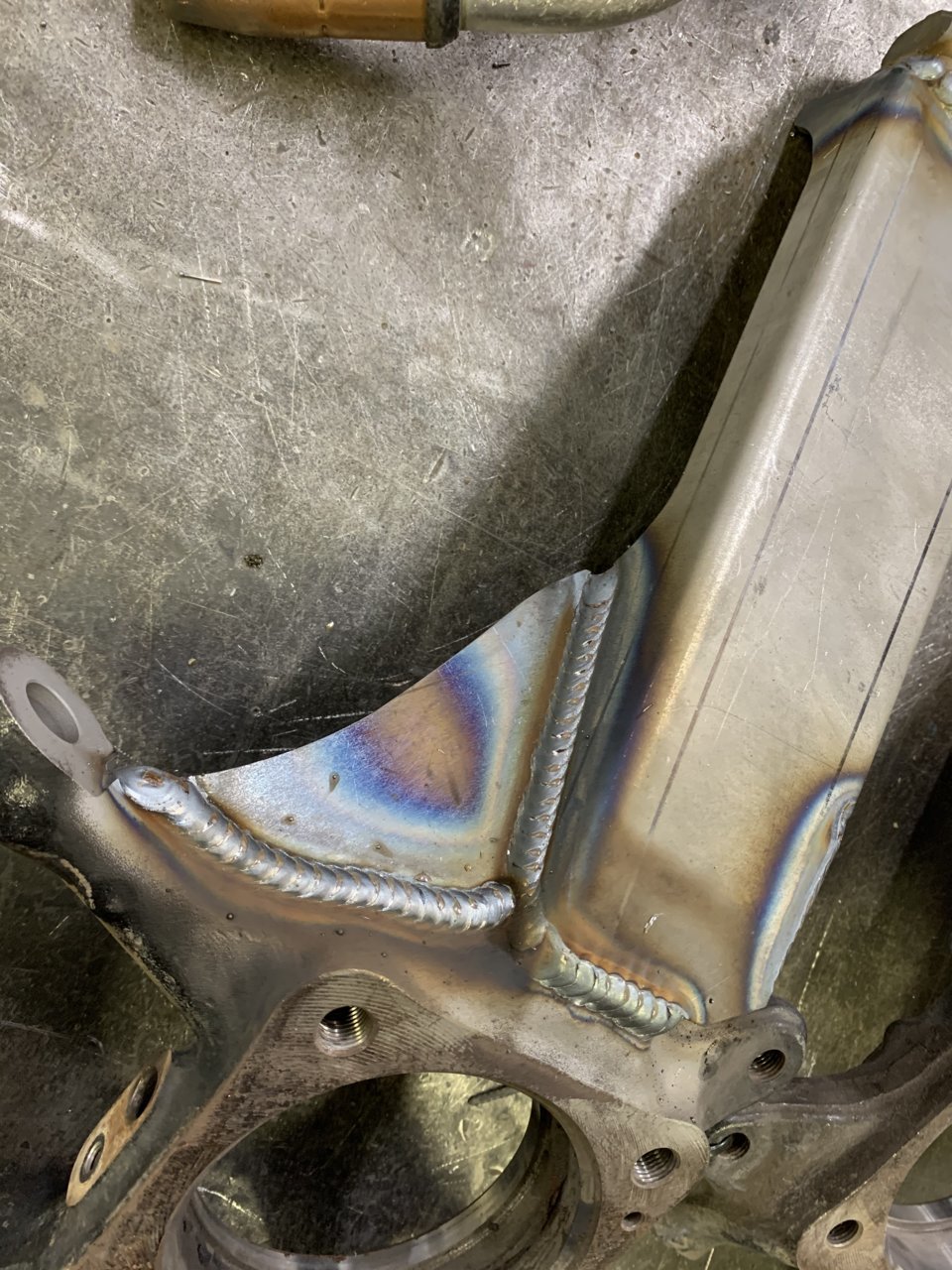

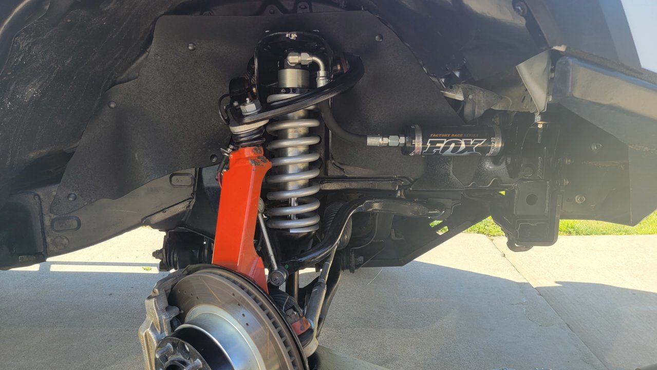

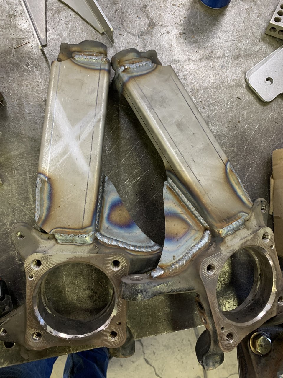

    First sets of spindles for 2021
    Here’s an install from the first. If you don’t want to deal with swapping cores and are local we do in house installs as well.

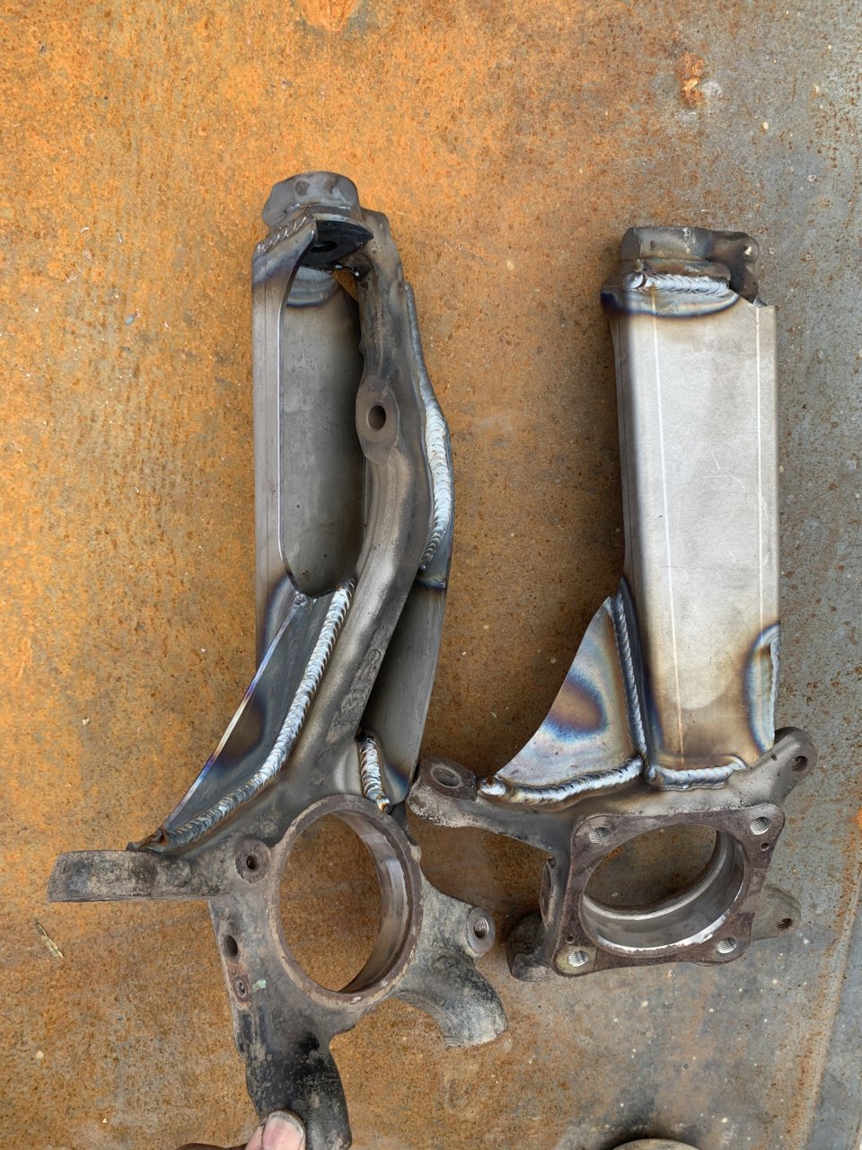

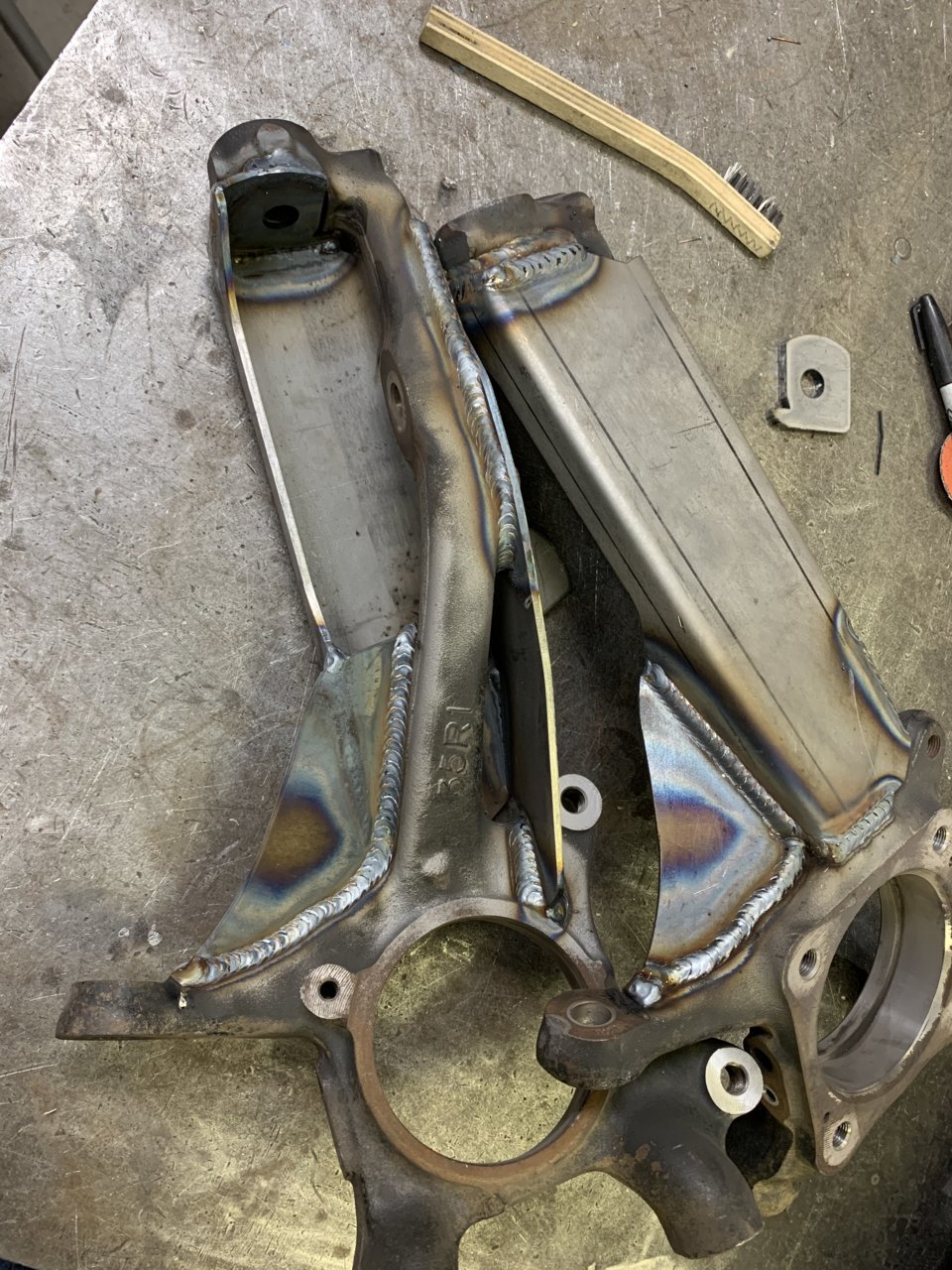

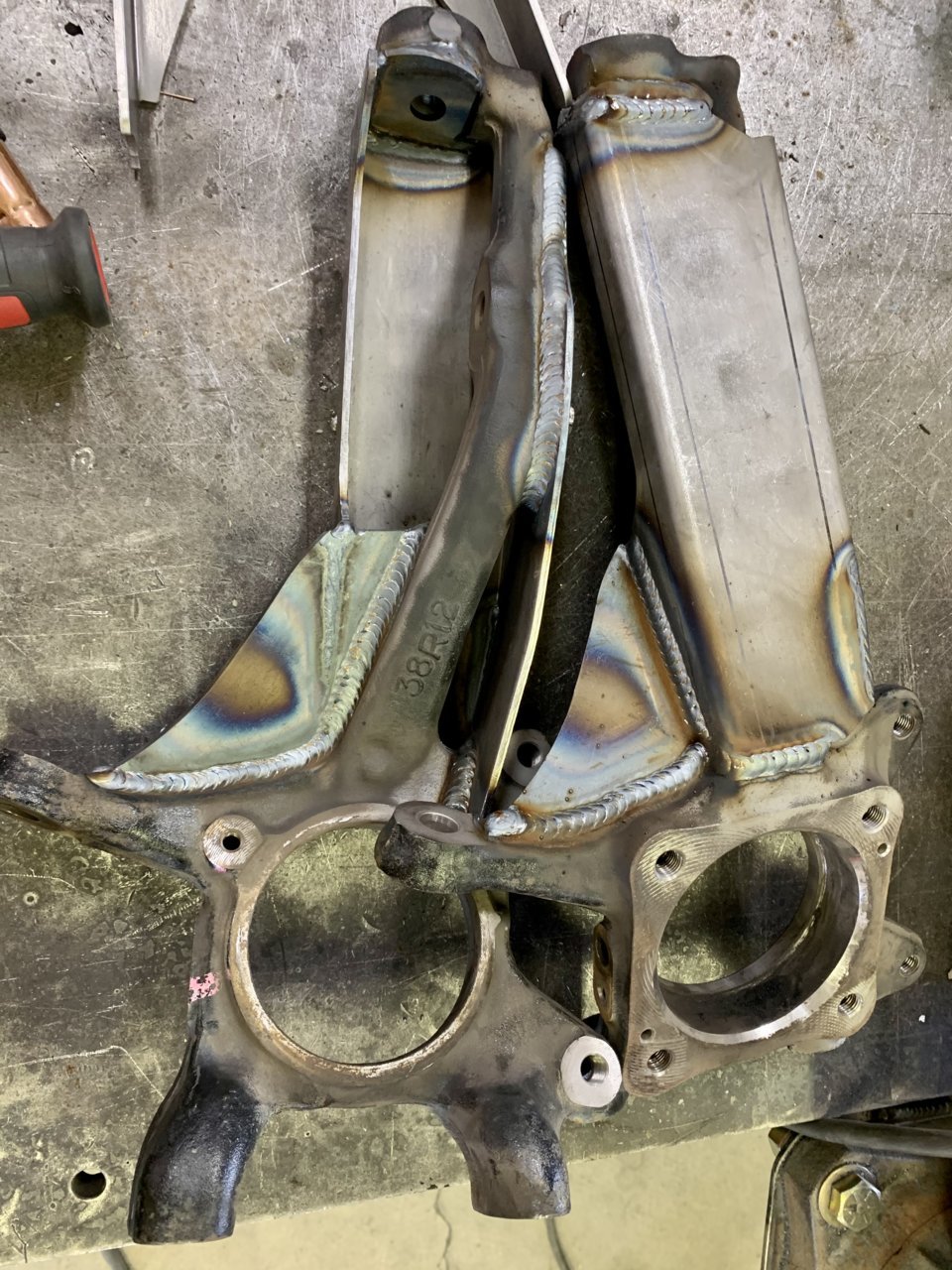

    Here’s another 4 sets that we welded up this weekend. All but one set are spoken for 2 are currently in the mail headed to their new homes.

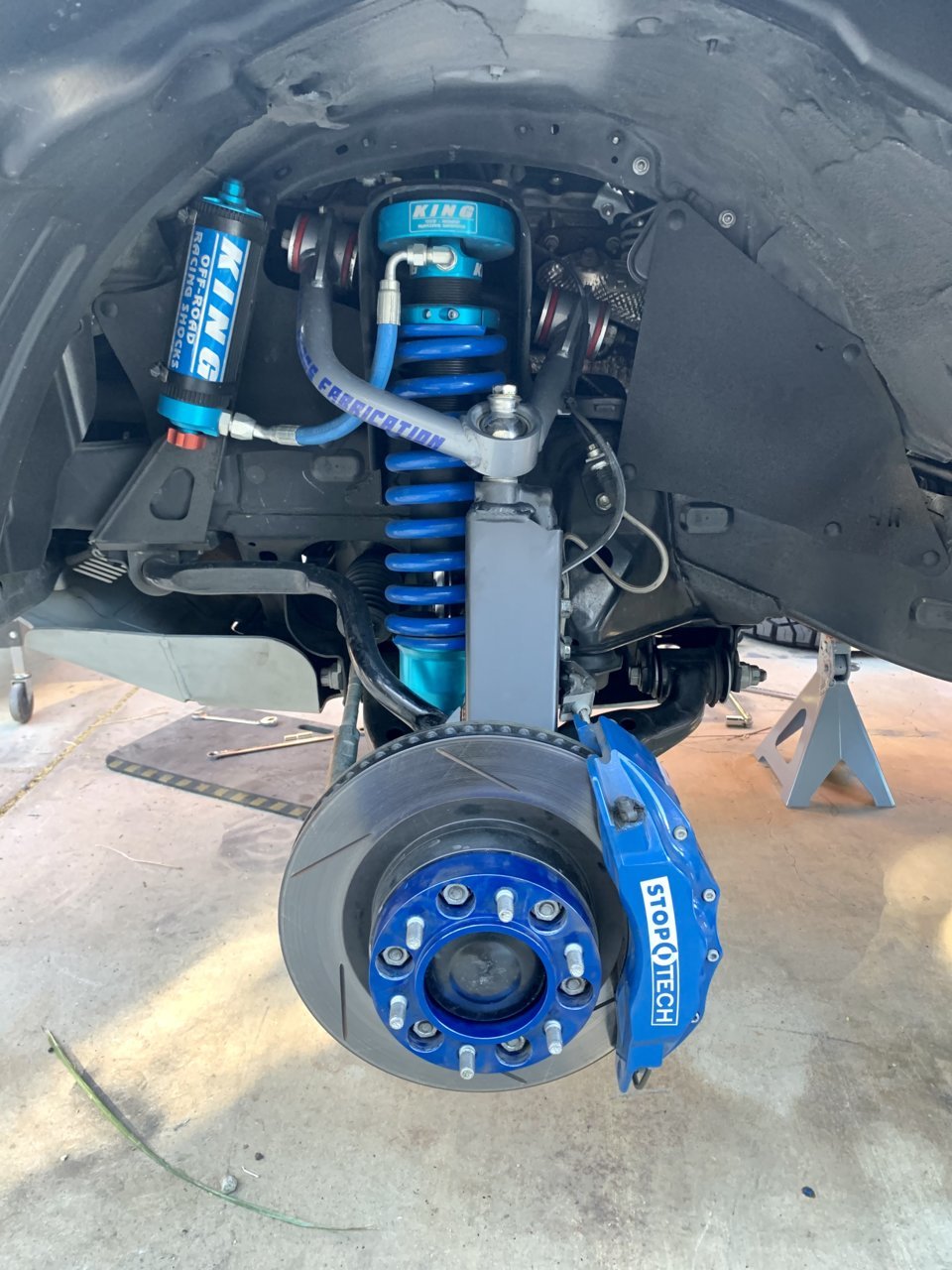

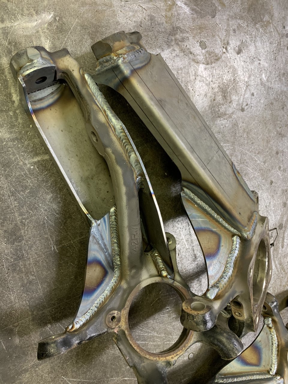

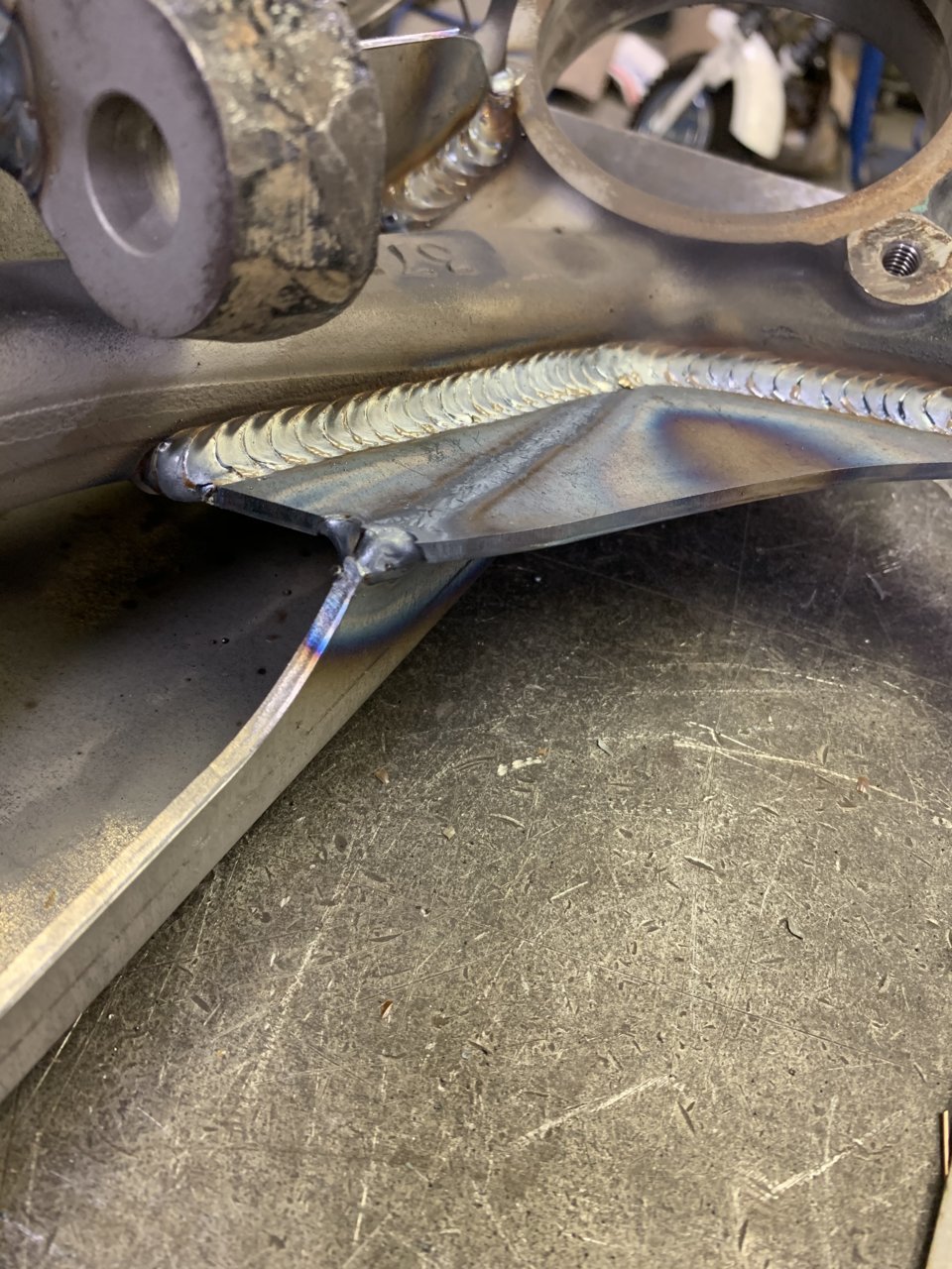

    Two more sets welded up this weekend and a vehicle install.

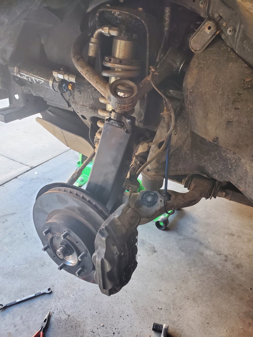

    Mine are still perfect after a year or so. Don't mind the fucked up paint 20210306_132342.jpg

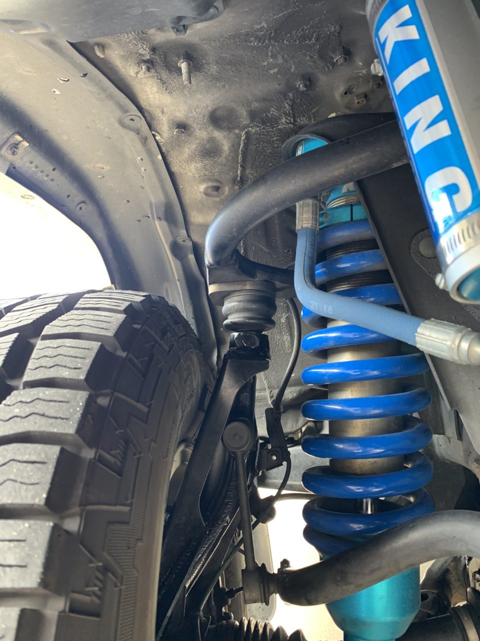

    Did you have to use a different upper ball joint nut to clear the gussets?
  20. Apr 12, 2021 at 6:24 PM
    #780
    Balot64
    Balot64 Well-Known Member
    Oct 24, 2011
    #65740
    209
    Jax to San Diego, now Jax again
    2012 Tacoma Offroad 4x4
    FX-R HID retrofit, G2 Bak cover, N-fab step wanna be, Pop & Lock, Weathertech digifit floor mat, LED interior, OME front and rear shocks, OME 884, LR UCA, Wheeler 3 leaf pack. FJ black trail rims with 265/75/16 Michelin LTX MS2
    Yes I did, that information is on the first part of this thread. upload_2021-4-12_21-24-9.jpg
