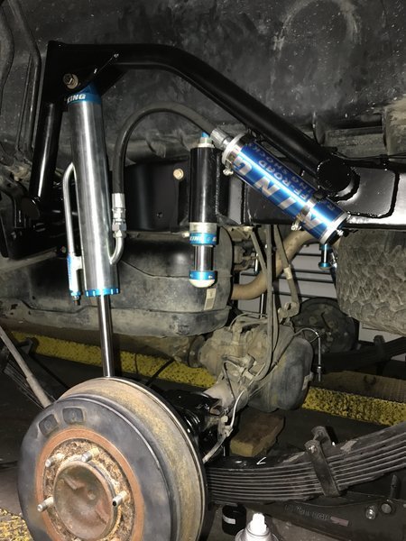

  15. May 3, 2018 at 6:40 AM
    #35
    glorifiedwelder
    glorifiedwelder IG= @Liquid_Torch
    Feb 14, 2015
    #148647
    3,658
    jason
    Santa Clarita, ca
    double cab trd sport
    You can run 14” shocks but they do hang fairly low, a little lower than the leaf springs. You can pull full travel from the kit using 12” bypasses. I personally think you’ll get a cleaner install with 12’s.
    MonkeyProof, jeff b and Coot83 like this.
  16. May 3, 2018 at 6:45 AM
    #36
    glorifiedwelder
    Feb 14, 2015
    #148647
    3,658
    jason
    Santa Clarita, ca
    This is a DMZ kit with 14” bypasses under the bed. This is the total chaos Morocco rally truck. This gives you a good idea of where your lower shock mounts will end up. You could get creative with your rod end on the shocks and get the overall length a little shorter.

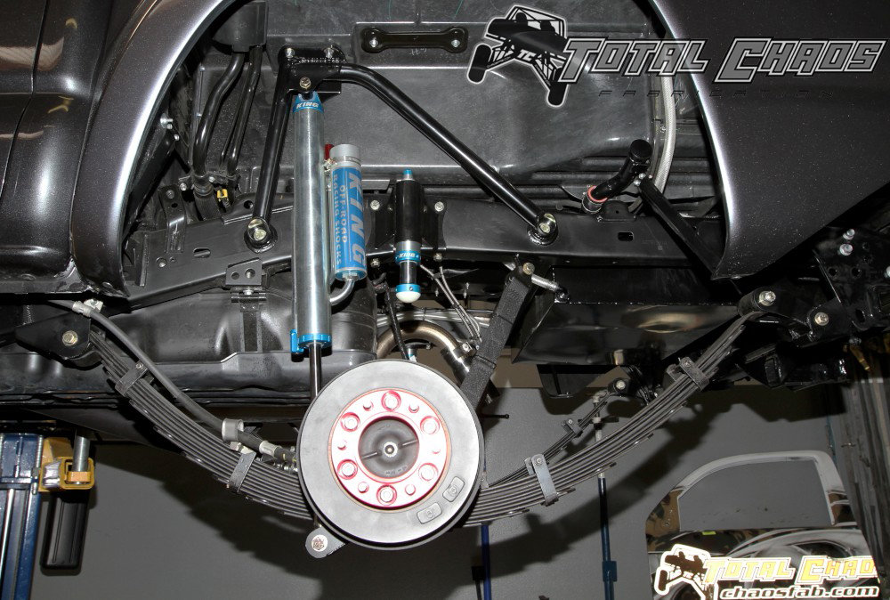

  18. May 4, 2018 at 1:54 PM
    #38
    glorifiedwelder
    Feb 14, 2015
    #148647
    3,658
    jason
    Santa Clarita, ca
    Here you go Mark. This is a TC sua kit with custom hoops I did
