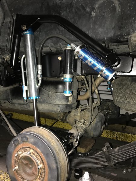

    So, has anyone one done the Total Chaos MT SUA with a dirt king/archive/mid travel shock relocation and respective hangers?
    I recently installed icon rxt’s at stage one with the dirt king hangers and shackles and while the ride is softer it’s still not what I’d like it to be.
    I say this to increase the possible shock length over the complete Total chaos relocate and SUA kit. Also, considering the dirt king hangers and shackles are sized for the deaver Tacoma springs, I don’t see why it wouldn’t work with Deaver’s SUA Tacoma springs. Hell, add in the dirt king frame notch and bump stops and you’re cooking with much more uptravel and probably the same or more down travel as the SOA setup I currently have. I don’t see any problems with this but really just brainstorming this. Any advice would be awesome. A lot of the idea and inspiration for this came from the attached photo since with the custom shock mount. Instead just do one of the ones listed above.
