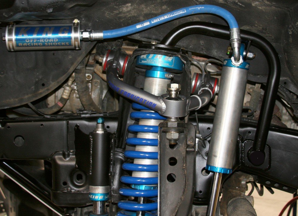

    with a longer resi hose and a remote mount i think running them inside the frame attached to a crossmember will work nicely. Probably how I'll do it with double bypasses.

    Not enough room for my liking between the frame and bed... plus, Sharp edges... why I went piggyback. I probably could have gotten away with no residential but that's no fun;)

    nah they are worth it i think. Makes it easier to rebuild yourself too haha
    Plus I think if you did the right fittings like 90º off the shock you'd avoid alot of the edges. But Idk. Haven't looked enough yet obviously.

    I have piggybacks on mine, and I wish I would have gone remote resi.
    FWIW, Micah valved mine as well, and they were like clouds on the street, but bottomed out badly, and would overcycle with any good hits. I contacted King and we bumped up the compression valving about 30%, now they still ride very nicely on road, but don't bottom out nearly as easily.

    Yeah and you can't add hyros with the solo kit with the shock placement.
    I think that would help a ton on the rear. But again..gonna rub that shit pretty bad. Still, be nice. I have the TC hydro kit too. But that will likely end up on Frankenstein as im gonna run the wider axle.

    Yes, the lack of somewhere to place the hydro's is making me consider switching to the Total Chaos kit to be honest.

    Don't get me wrong, I love the solo kit, but my only other option would be to take a hole saw to the frame and French the bump into it. Which would work for some sleeper points lol.

    Notching the frame would suck. Plus if you switch you'd have to get 2'' shocks as the 2.5s will not fit. No way in hell with the TC kit.

    Run a taller hoop with 12" shocks. Can't remember, are you SUA? If you're going custom, there's no reason to limit yourself to a 10" shock in the rear.
    If I did it i'd go to 2.0 twin bypasses. Or i'd see if I could talk TC into doing a custom one to fit my 2.5's and run hydros. No point in running a bypass and a hydro in a little truck like mine. Kind of overkill. I'd only run the bypass to act like a bump zone.

    yeah plan is 12'' double bypasses with resis and hydro bumps. Not SUA. still SOA and am fine with that. I think it'll hold me over nicely for a few years. Im just gonna link it instead of doing a full bed cage and SUA. Need to get a more permeant place to live first though.
    Be cool if they made one for 2.5s. I think if you're gonna have a GFC and camp gear the hydros would be worth it. Weight is the enemy here. They really help. I've been in a 2nd gen with the older Pelfry built relocation kit and hydros and its stupid plush with full armor and some tuning.

    you don't have resi up front do you right?
    Thats why I love the front LT. Was so damn worth it. Eats shit up the stock front could never do. Its amazing. I wish FROR Would pull their head out of their ass and finish the 2.5'' LT kit. Think that would be great for a mid travel romper rig.
    hydros up front? mm..im not a fan of that idea. Some nice rubber ones are better I think.

    No resi up front, King doesn't like doing it, but they will build a set with them if you ask nicely. I could always do that too, but packaging is super difficult for stock width and a hydro, and a smoothie plus hydro and mounting is about the same price as the hoop and a bypass.

    I don't think you'll fit a hydro up front well period. Nor will it work well as you'll be in the bumps at ride height even on a 2'' stroke. 1'' stroke doesn't seem worth the effort and cost vs a Superbump and bypasses.

    Well, apparently TC doesn't agree with you lol. They fit a coilover, smoothie, and a hydro in the front.
