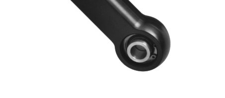

    I thought the TC LCA didn't work if the shocks had lower rods that had bushing.

    Correct me if I'm wrong, but I thought OME fronts had ball joint type ends like most other coil-over setups?

    @Seabass
    That's a bushing lower rod end vs a coilover spherical bearing
    ^ @TOTAL CHAOS
    Is OME a fluke as it looks to fit?

    Race Series Lowers & Shocks w/ Bushing Rod Ends
    *Not compatible with shocks with bushing lower rod ends is referring to an OE type shock with large rubber bushings or something like the TRD Pro (Fox). The bushing lower rod ends contact the top plate (under compression the rubber bushing flexes and shoves the rod end into the arm) on the lower arm and rub. This creates a binding effect and can result in failure.
    The note was based on our current testing with bushing lower rod end shocks. We haven't tested every shock on the market so it's quite possible the Old Man Emu won't have problems.
