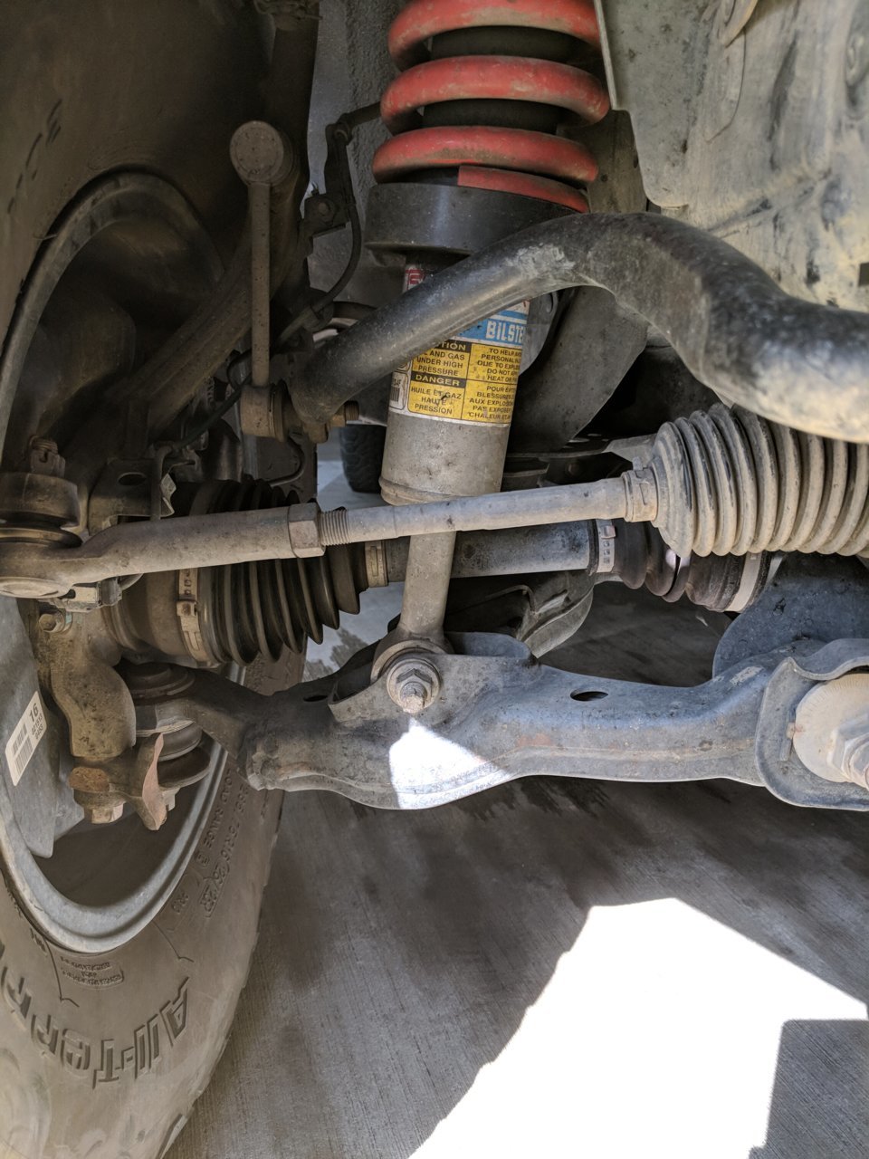

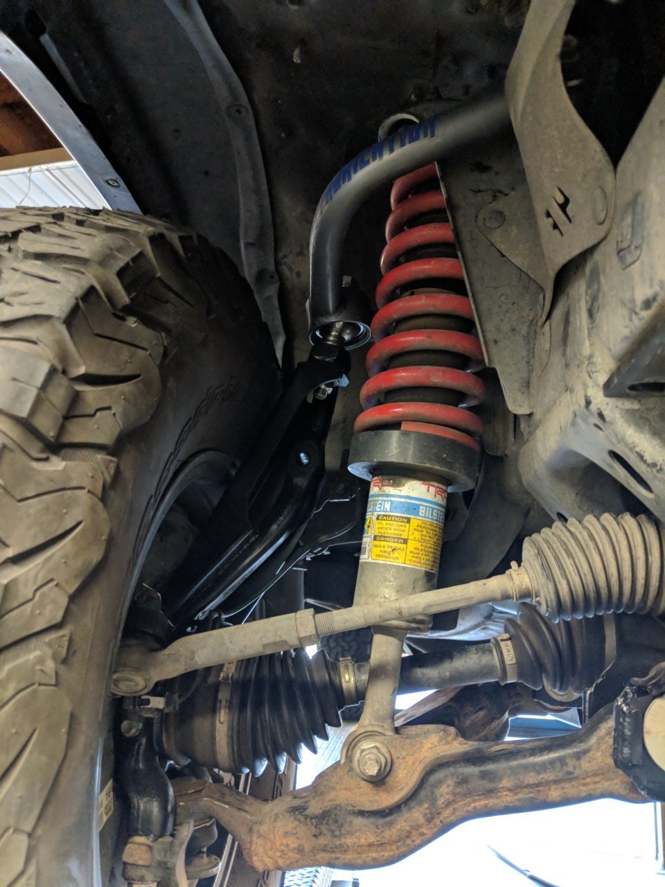

    This is what it looks like with the steering stop removed from the stock lower ball joint adapter

    And here is picture of the stock LCA.
