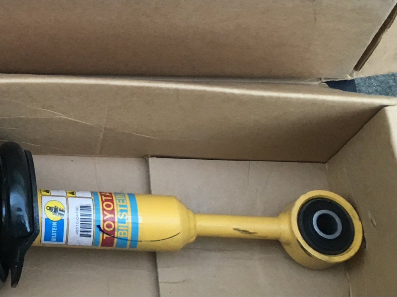

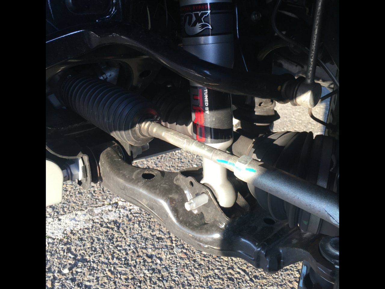

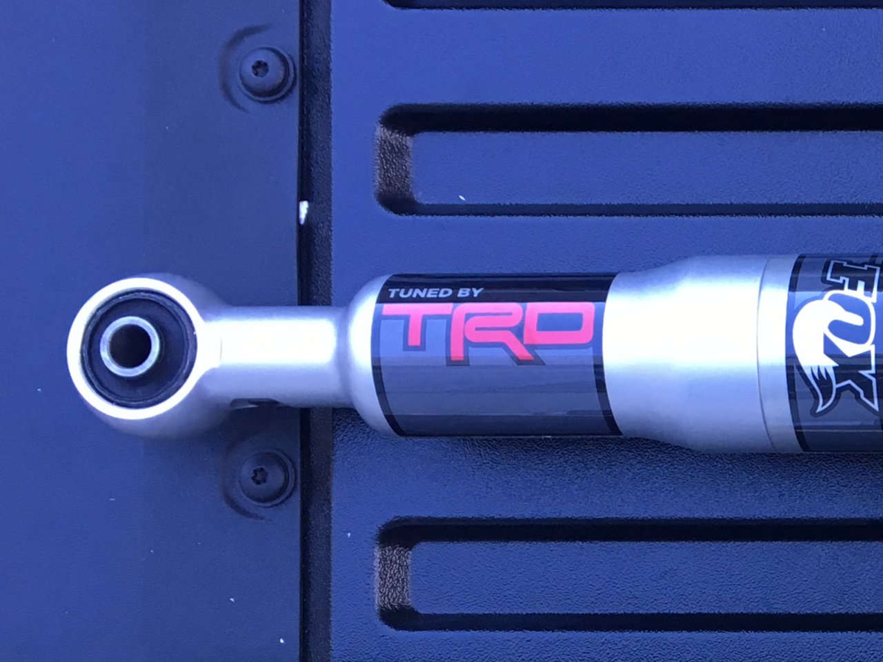

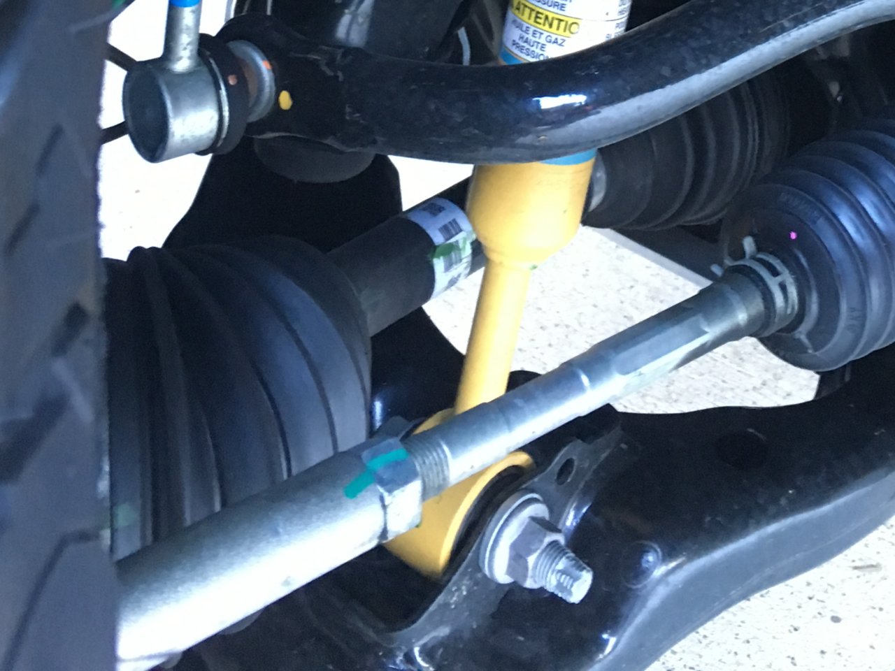

    Cool thanks for the info...I took a look at the lower end of my Fox Pro shocks vs. the old factory OEM Bilsteins & I did notice the difference in dimensions and bushing. So if I’m reading your response correctly your LCAs have not been tested specifically w Toyota’s factory OEM Pro Fox shocks but just with other smiliarly designed shocks from other manufacturers that have bushing lower rod end.
    My thought is if the Toyota factory LCA will accommodate both Bilsteins & Fox with bushing lower rod end then I can logically conclude your TC LCAs must be uniquely designed with proprietary fitment that somehow may or may not be compatible w Fox due to possible contact with arm.

    The issue is clearance.
    They will bolt up and on the road will probably be just fine. However when you look at the stock LCA you can see there is a bucket where the shock mounts up. On the TC LCA its flat under the shock.
    There is a chance that the deflection of the bushing could be enough that the bottom of the shock rod end could make contact with the top of the TC LCA. This may or may not cause any damage.
    TC has seen this happen with other shocks with bushing rod ends so they cover themselves buy saying DONT DO IT with ANY shocks that use bushing lower rod ends..
