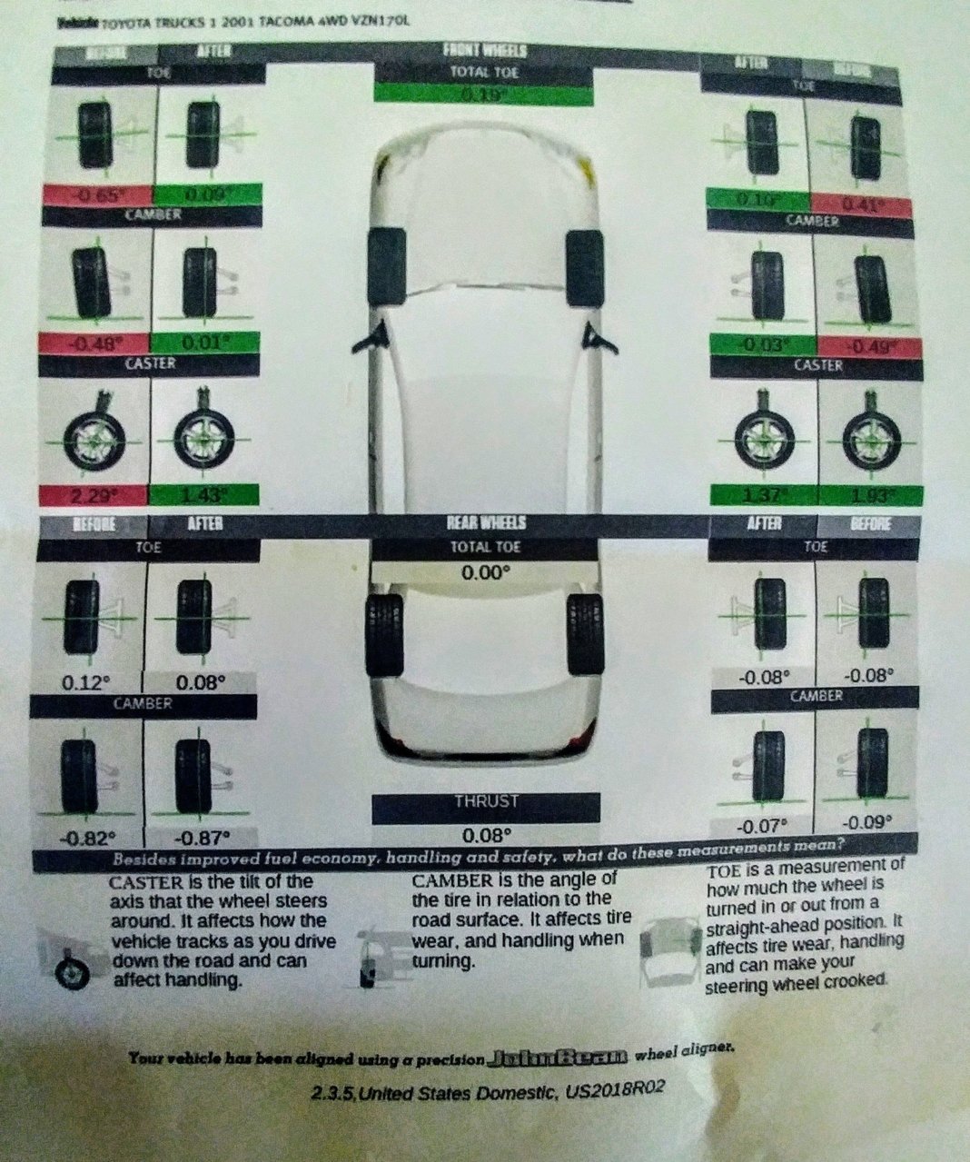

    @TOTAL CHAOS I'm having a tight steering, not always returning to center "thing" right now. Just installed new UCAs (actually MCM Fab ones, to be honest) and they are uniball design. I noticed it right away when I drove the truck after installing. Thought maybe an alignment would help - though the stiff steering and not returning to center right away still persists. Now I know you have no reason to respond to my post since I'm not running your product and I have been utilizing your info and videos for making sense of my uniballs and how to care for them, etc. So thank you for putting this stuff out there!
    If I may ask, how do my numbers look?

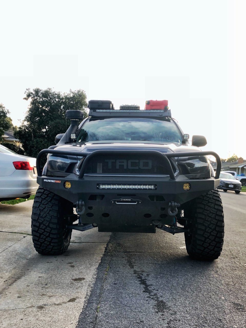

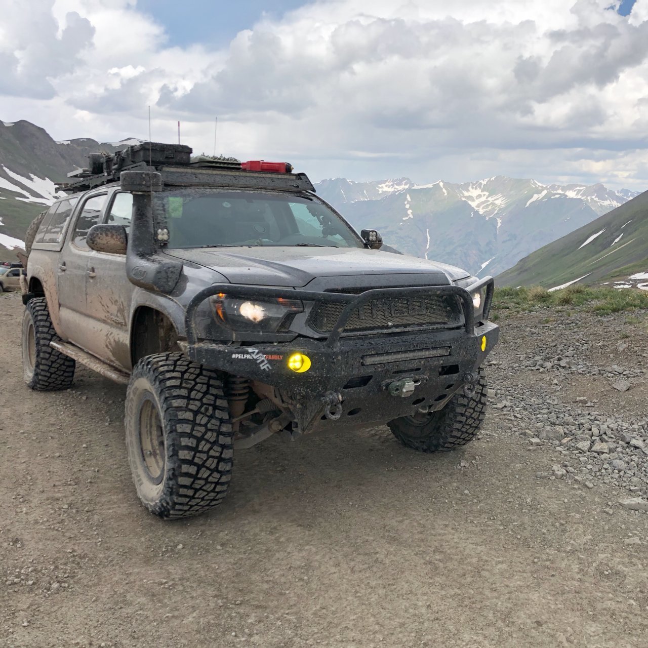

    A buddy and I are both running SCS Ray10's with 3.5 backspacing -38 offset and it works. I have some slight running on my bypasses which we are figuring out but aside from that it clears the rest. Talking with TC we think we can move it in some more as its only rubs on load and not on a basic turn test.
