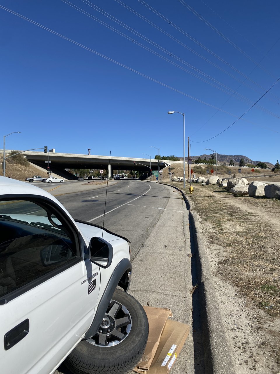

    Hey everyone, new to the forum but I’ve owned 3 Tacoma’s prior and first time owning a 4x4 Tacoma. I just bought this 2002 5speed truck a couple months ago and while driving on a paved road my wheel decided to come out of the ball joints (luckily it happened 50’ from the freeway entrance). I have major doubts about the truck now so I’m looking for lift options that would replace the UCA and LCA, and perhaps the cv axle and steering stem rods. I only found one option so far online (total chaos lift). I was hoping to get more insight and possibly more options for a sturdy and proper lift

    Welcome to TW, that looks ugly.
