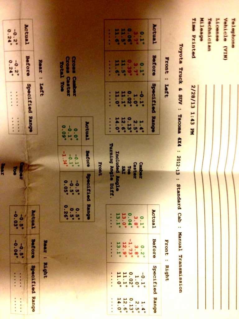

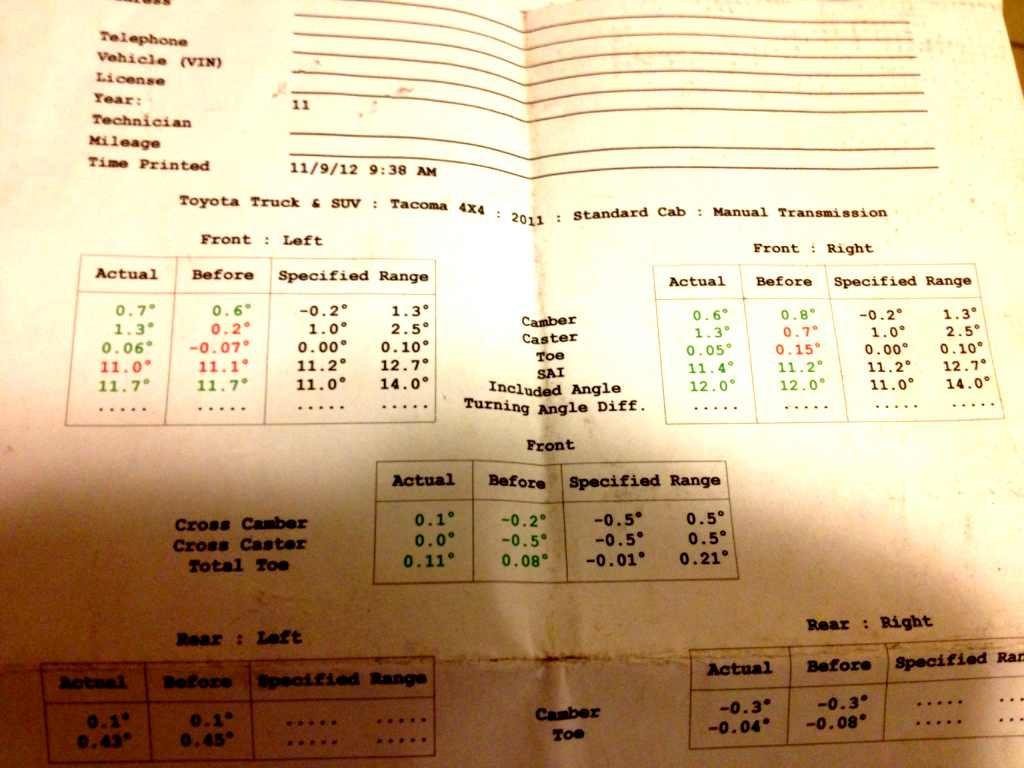

  18. Feb 28, 2013 at 3:42 PM
    #38
    Millertime187
    Millertime187 [OP] I'll be your huckleberry!
    Sep 25, 2012
    #87698
    1,922
    David
    Clay City, KY
    1995 Taco
    Just a few little things. It's my DD
    How does this alignment look?
    Today
    Before UCA and with spacer lift

  20. Feb 28, 2013 at 4:04 PM
    #40
    BigHeadTaco
    BigHeadTaco GFY
    Jan 2, 2013
    #94237
    458
    Big Head
    Full OME lift 885's with Dakar leaf springs. LR UCA's. ImMrYo relocation bracket.
    So, no more rubbing the cab mount with 3.7/3.8 caster? ? ?
