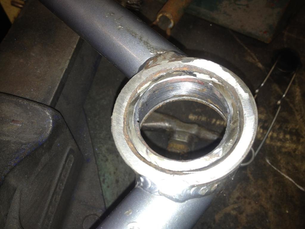

    I've got an 08 tacoma that came with TC UCA, the uniballs needed replacing, and upon removal, I see that whoever installed the last set must have gone WAY too hard with a hydraulic press, as the retaining cup/lip is pushed way out/folded over. I'm choked, I haven't gotten to the other side, but im hoping I can grind out the lip, measure the depth of my other one, and weld in a retaining ring/salvage the UCA.
    I dont even know how this damage would be possible, outside of maybe when they were changed last they were attempting to push them out the wrong way? not paying attention when setting them up to be pressed out? I'm a HD mechanic, I realize shit happens. But this still sucks.

    I'll throw some pics up tomorrow. I saved the UCA. There was scoring in each UCA, the one with the damaged lip being the worst. I'd say bearings being pushed in crooked with a hydraulic press.
    As for the maintenance, I've has this truck for under a year and this was the first time ive had a tire off.. Field mechanic, so service truck was my DD, and I had a '00 Tacoma for wheeling. Sold the '00 and transferred to a shop position though, so my 08 is no longer just the grocery getter/mall crawler.

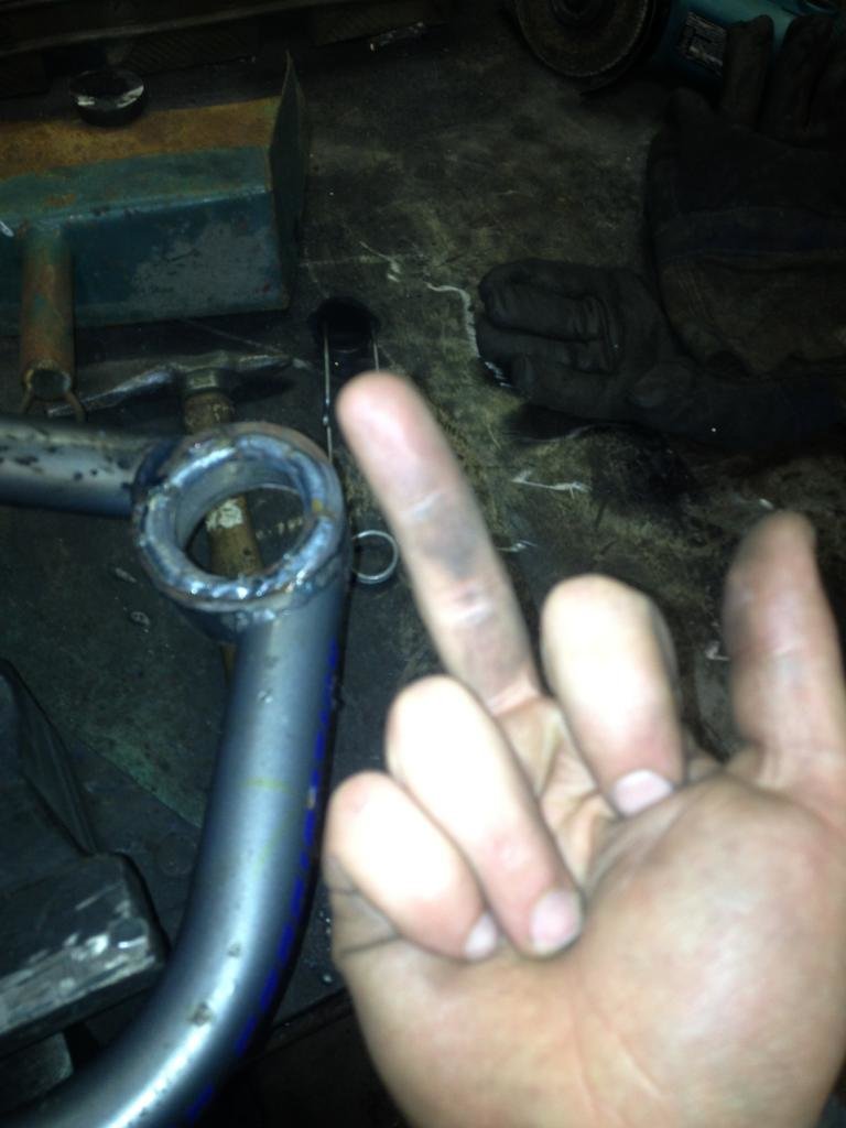

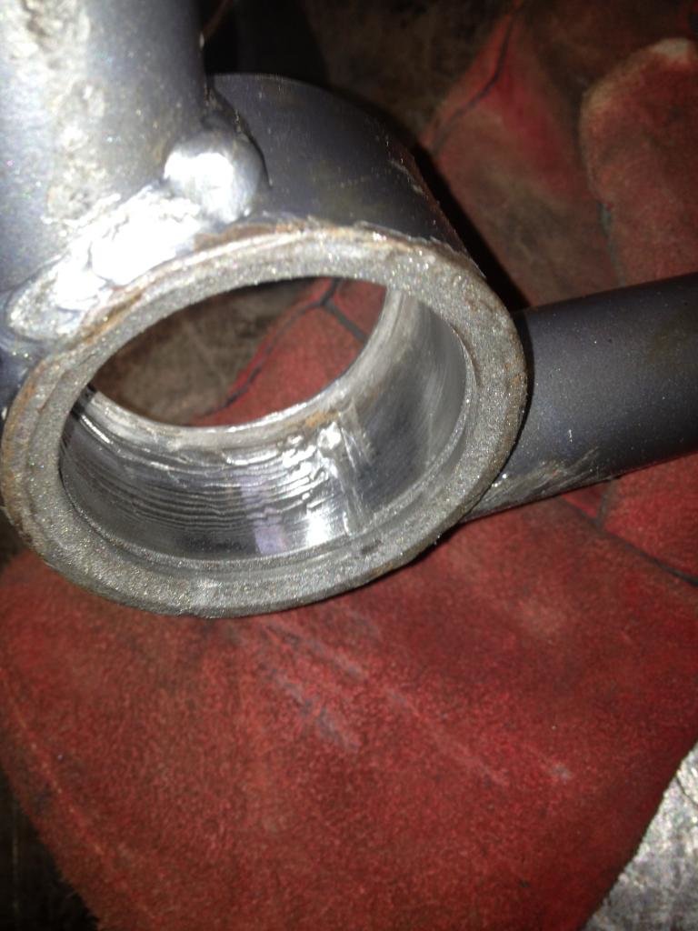

    If these don't belong here, sorry. I'm a big fan of Total Chaos products, this damage is completely user error. The first pic is of the drivers side UCA (most damaged), after I had polished out the deep scoring as best I could. The Uni-ball assembly didn't push in as tight as I'd like, but I had to make it work for the time being.
    Sorry for the bad pic, but if you look closely at the left of the UCA you can see the cup flared out slightly. I'm assuming this is from attempting to push the bearing out the wrong direction?
    The retaining lip was pooched, I ground it out, measured the passenger side for the depth, pressed in a slice of the old bearing race and welded it in to act as a retainer.
    Good reminder to any would be mechanics, use proper tooling, and most of all, your head. Or some poor fuck gets stuck farmer fixing your mess down the road. I will be replacing the UCA's asap, but it's fine for now.
