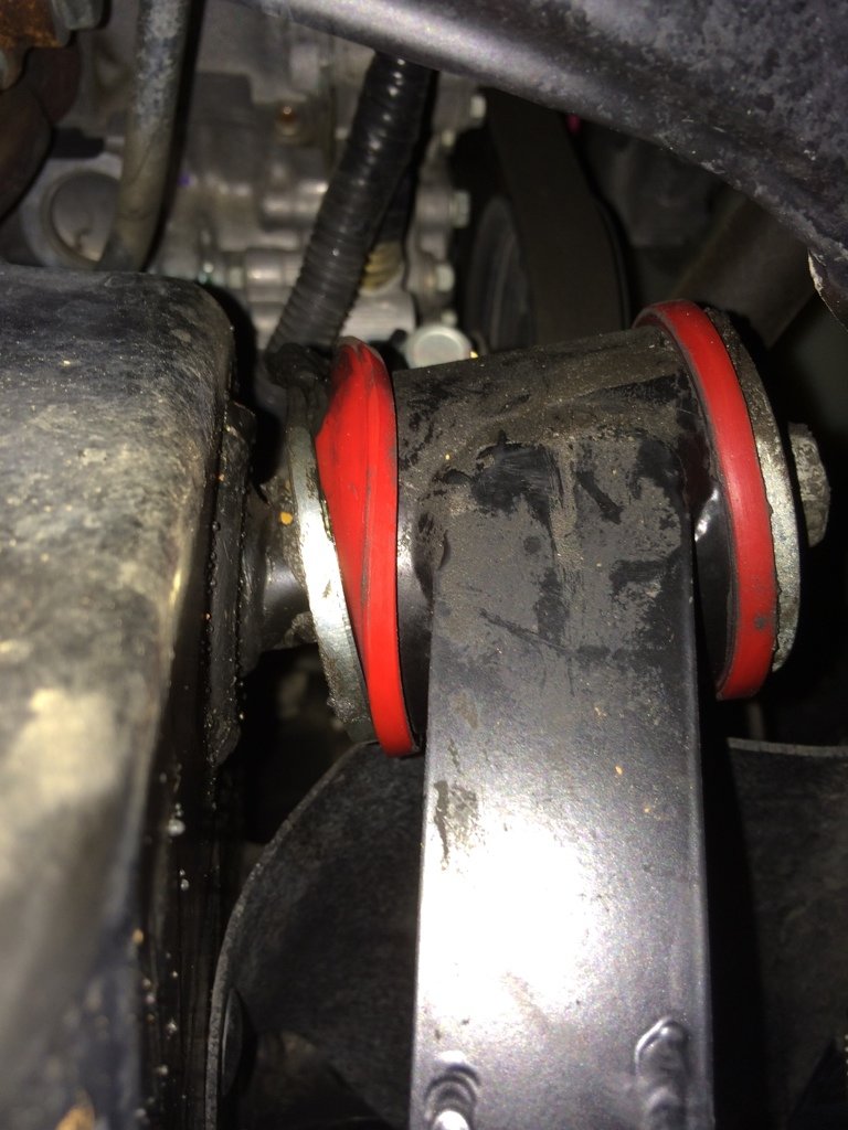

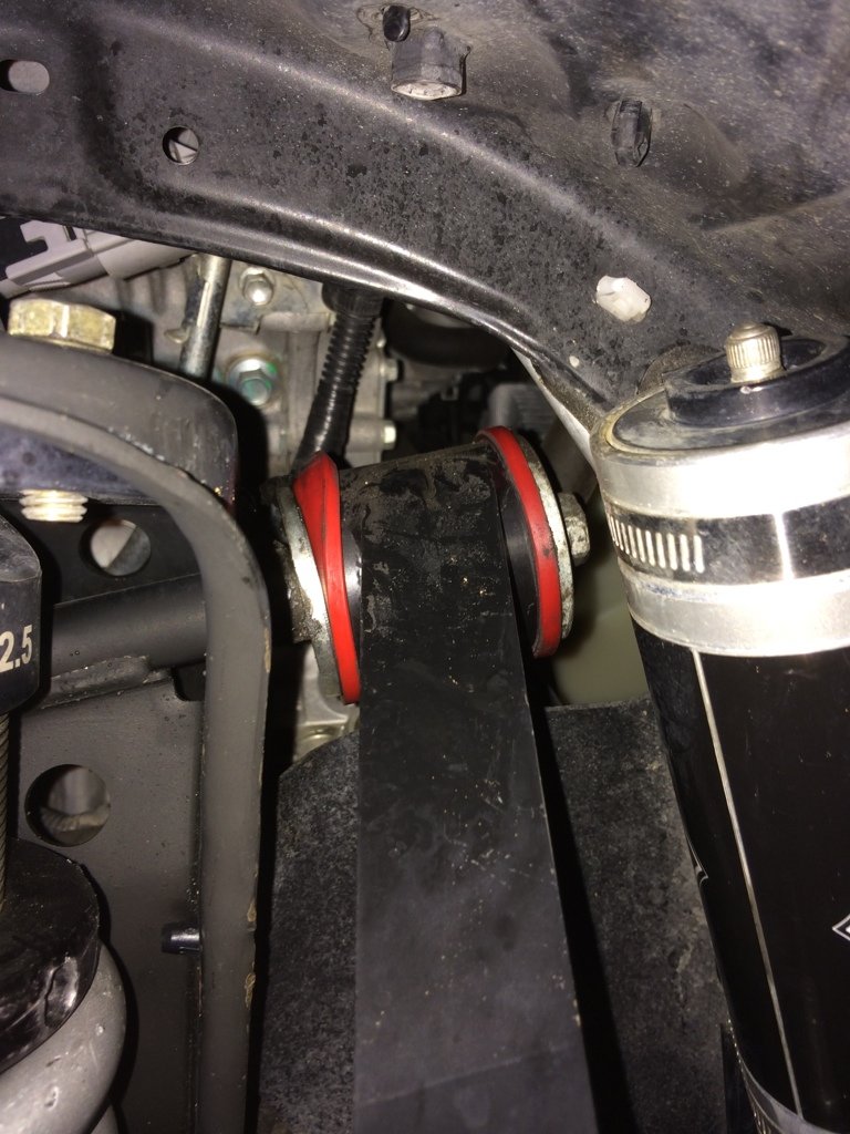

    What's the best way to replace this bushing? Ordered a new one and waiting for it to arrive.

    a full reinstall is in order basically. you'll need to remove the whole UCA in order to put the bushing and sleeve in the arm. I mean. you could probabyl try to do it with it still attached to the spindle but would be as much of a pain in the ass as just removing the whole UCA.

    Ok thanks, do you think the bolt was just over torqued?

    Could be but, I think typically that happens from over-greasing.
    EDIT: upon further thought, not really sure how this could happen. I believe with over-greasing, the bushing would be bulged out evenly the entire circumference of the bushing. Since you're is only blown out on top, I'm not sure how that would happen. and over-tightening should be similarly even as with the over-greased scenario....so I have no idea how this would happen.
