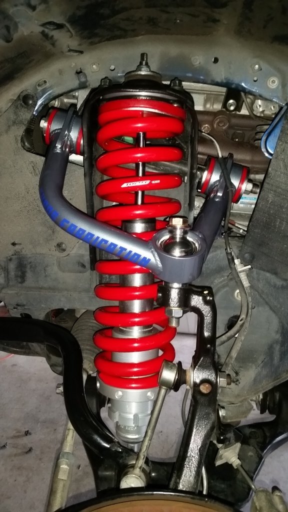

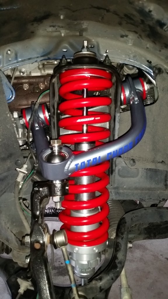

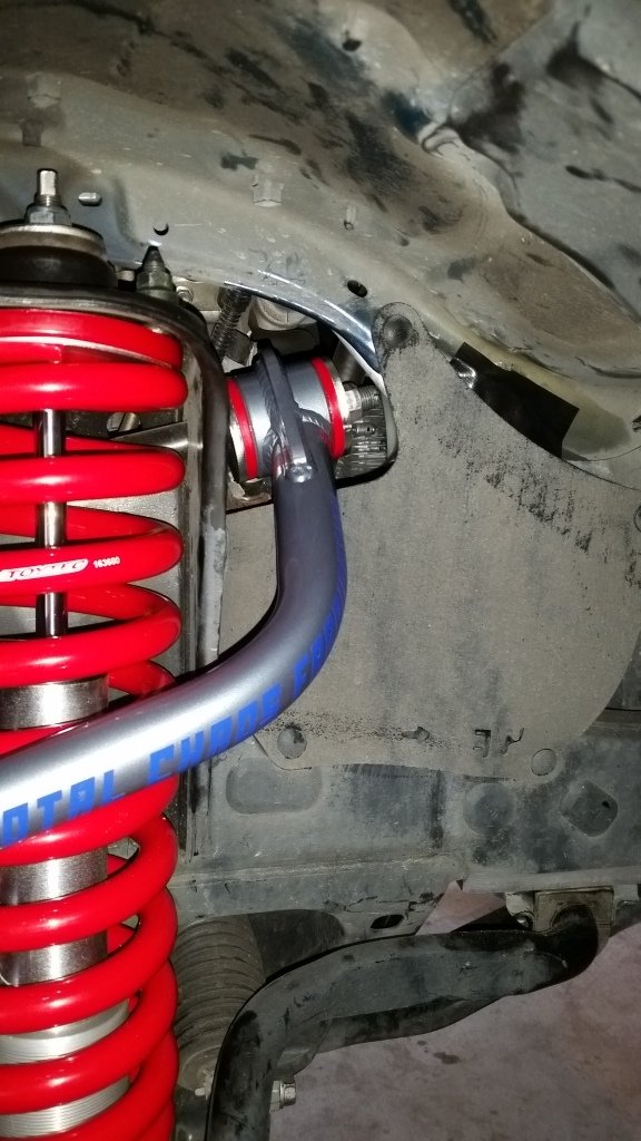

    Installed my TC UCA's and coilovers. Here are a few pics. When tapping out the bolts with an socket extension on the pass side, I had to use one that was longer than the standard size. If not, you'll be hammering all day, lol. And putting 2 together won't work as the fatter part is too large to go in the bolt hole.
    I covered up the sheetmetal I had to bend on the passenger side with gorilla tape. I cleaned the surfaces with alcohol first so it would stay put. Gave it a cleaner look. Drivers side is all covered with apron.
