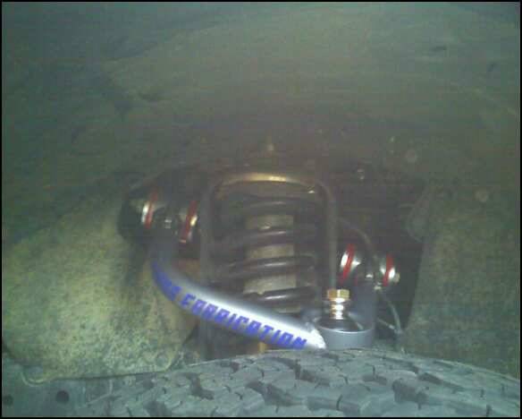

    So here i am on this beautiful saturday afternoon, assembling the UCA's so they are ready for install tomorrow...I start with putting the zerk's in. the first zerk i tried putting in, the first couple threads went by hand OK, then nada. So i got a wrench and slowly and carefully started to thread it more, got it almost all the way in, and the f*cking zerk BREAKS. I now have the threaded part of the zerk stuck in the UCA. I tried pulling it out with a bolt extractor, but it wont freaking budge.
    help? :mad:

    can someone elaborate on this part...
    the OP's directions say to remove the ball joint (19mm) and loosen the top nut (22mm)
    I removed the 19mm nut on the bottom, wheres this 22mm top nut?? i cant figure out how this comes apart.. :confused:

    Sep 23, 2008
    #9417

    No nut on the ball joint. Hit the bottom threaded part with a hammer. It will pop out.

    i ended up getting it apart, i used a crow bar, and it popped right up :eek:
    ready to bash on me?
    I get it all together, and start to move my truck and park for the night - and at that point i realized i forgot to hook the sway bar back up. when i turned right, it tore the lower CV boot, and sprayed grease everywhere. lol
