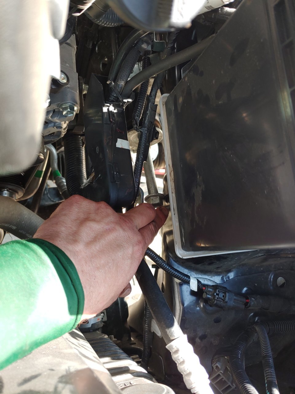

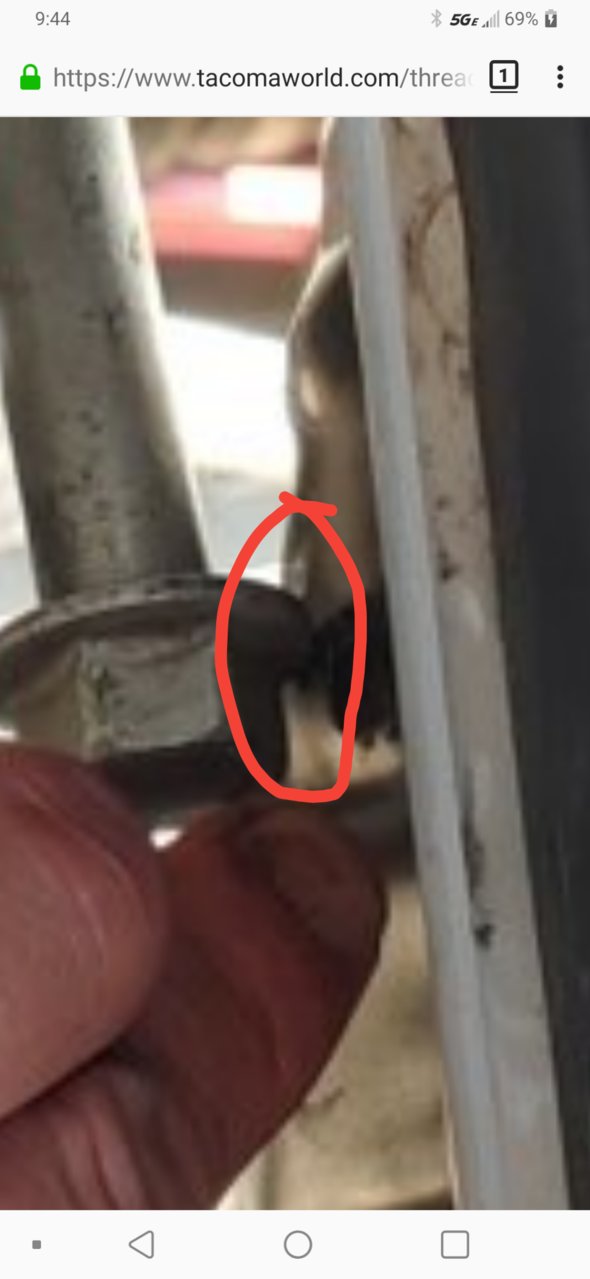

    It's a billion'th of an inch. What's the worst that could happen
