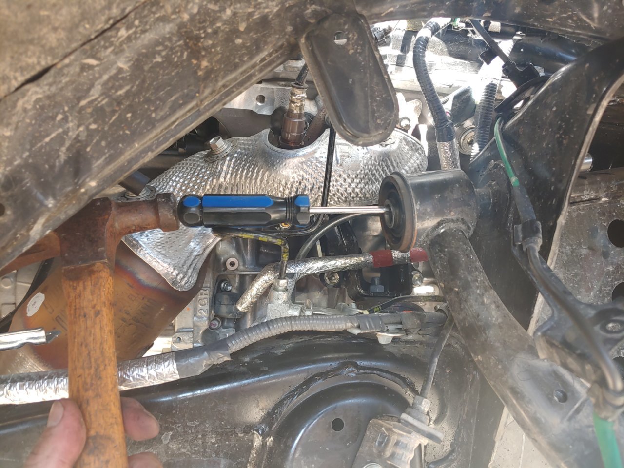

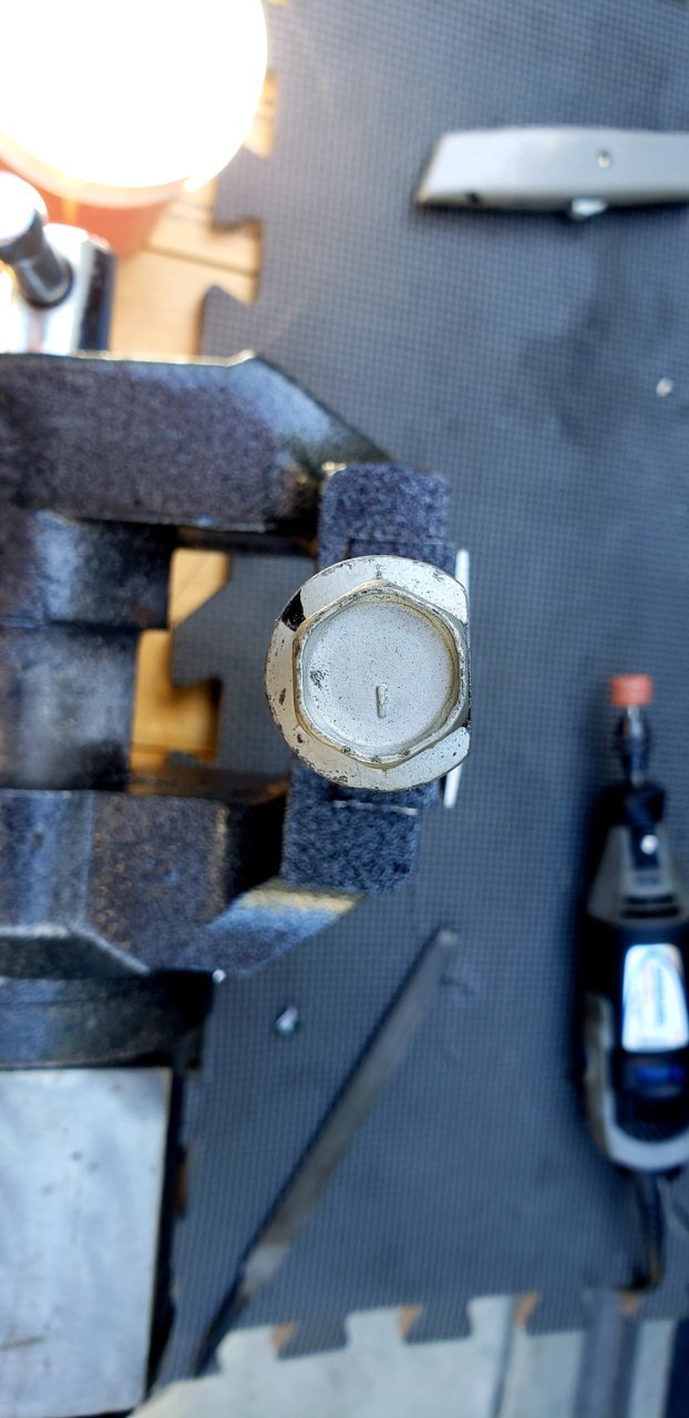

    Here's what I discovered is the easiest way....20190811_101405.jpg 20190811_100652.jpg
    crizq0 likes this.

    I use a pneumatic chisel and pound the sheet metal back.
    But before I reinstall that bolt I grind down one of the flared portion of the blot head that way it clears with no problem in the future if I ever need to remove it again.
