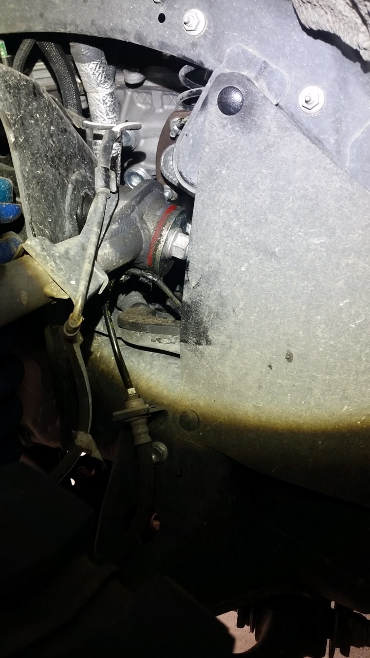

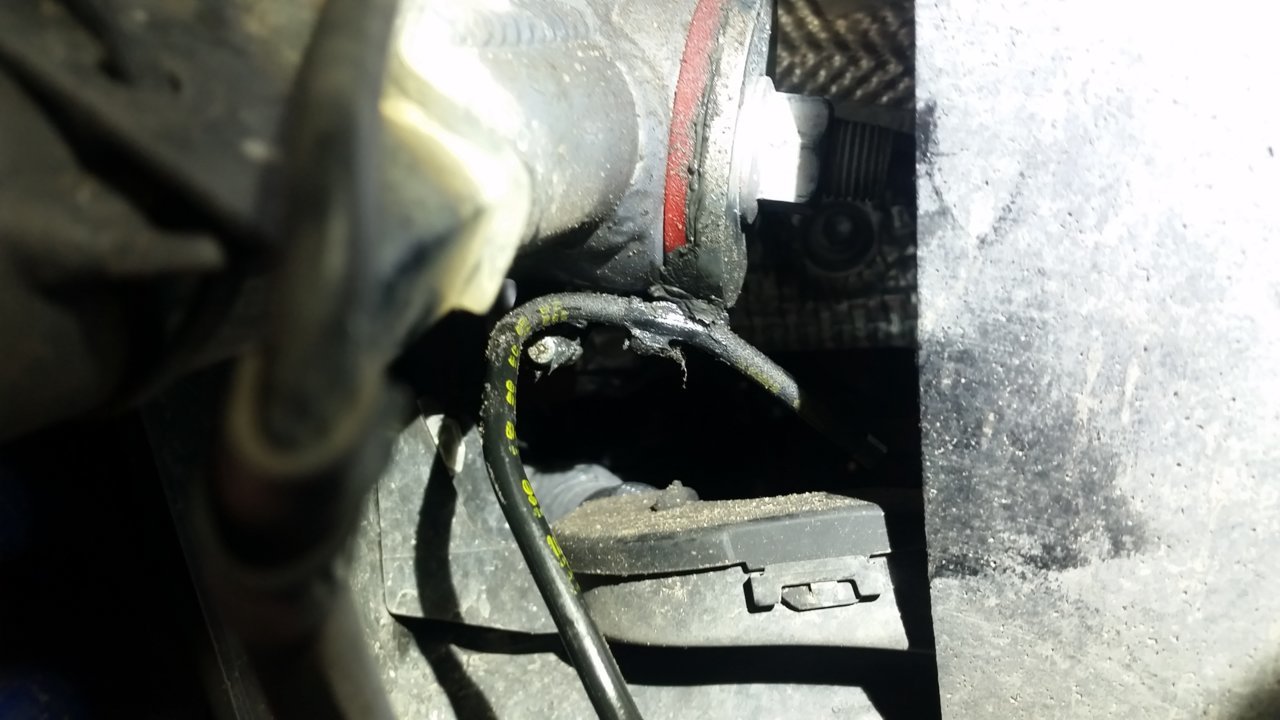

    Im trying to grease my uca bushings for the first time and am running an issue accessing the zerk fitting on the driver side due to a brake line in the way. The line is stiff and didn't want to pry on it and accidentally break something. The passenger side is clear and not an issue. Advice?

    There's a bracket holding that brakline in its place. Have you tried removing the bolt from the bracket? That should give you the room you need.

    Thanks I’ll give that a shot. I’m by no means a mechanic an didn’t want to accidentally damage a brake line prying on something that shouldn’t be.

    You should be able to bend the line slightly to allow for clearance. Also, you should take the metal bracket off your ABS wire and zip tie the line directly to the tab on the UCA.
