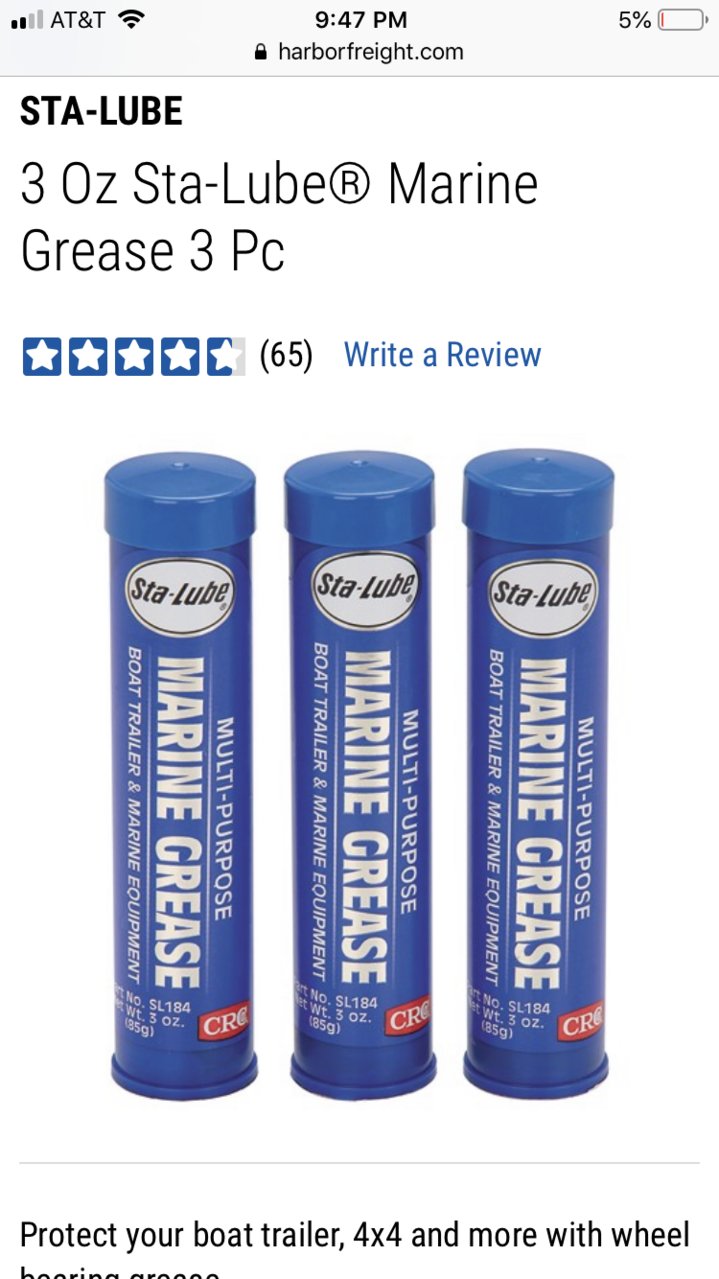

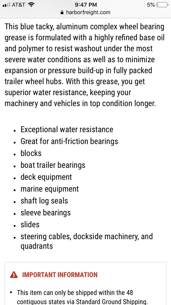

    @TOTAL CHAOS So I should’ve looked here about 48hrs ago... I just installed UCA’s. I didn’t receive any instructions but I found your video which was extremely helpful. I didn’t notice instructions on greasing at first but saw to loosen the bolt before pumping grease. Wasn’t sure how much to pump in. I think I pumped 5-7 times on each fitting. Also I didn’t know types of grease mattered. I used marine grease from harbor freight (posted pics above of specific grease). Is this something I need to have removed right away or should it be ok? Also reading previous posts should I release any pressure through the zerk? Thank you!

    Don't feel like you need to remove the grease immediately, we've seen customers use a similar grease before. If you experience noise or any issues, then we definitely recommend switching out the grease. If the bushings are bulging at all or deformed, releasing some pressure in the zerk fitting will help

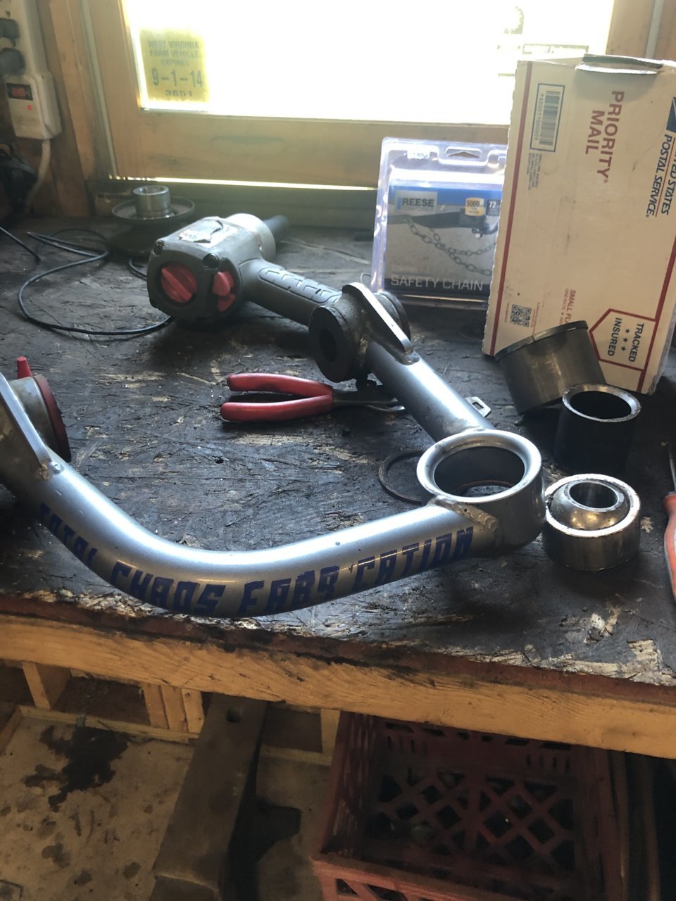

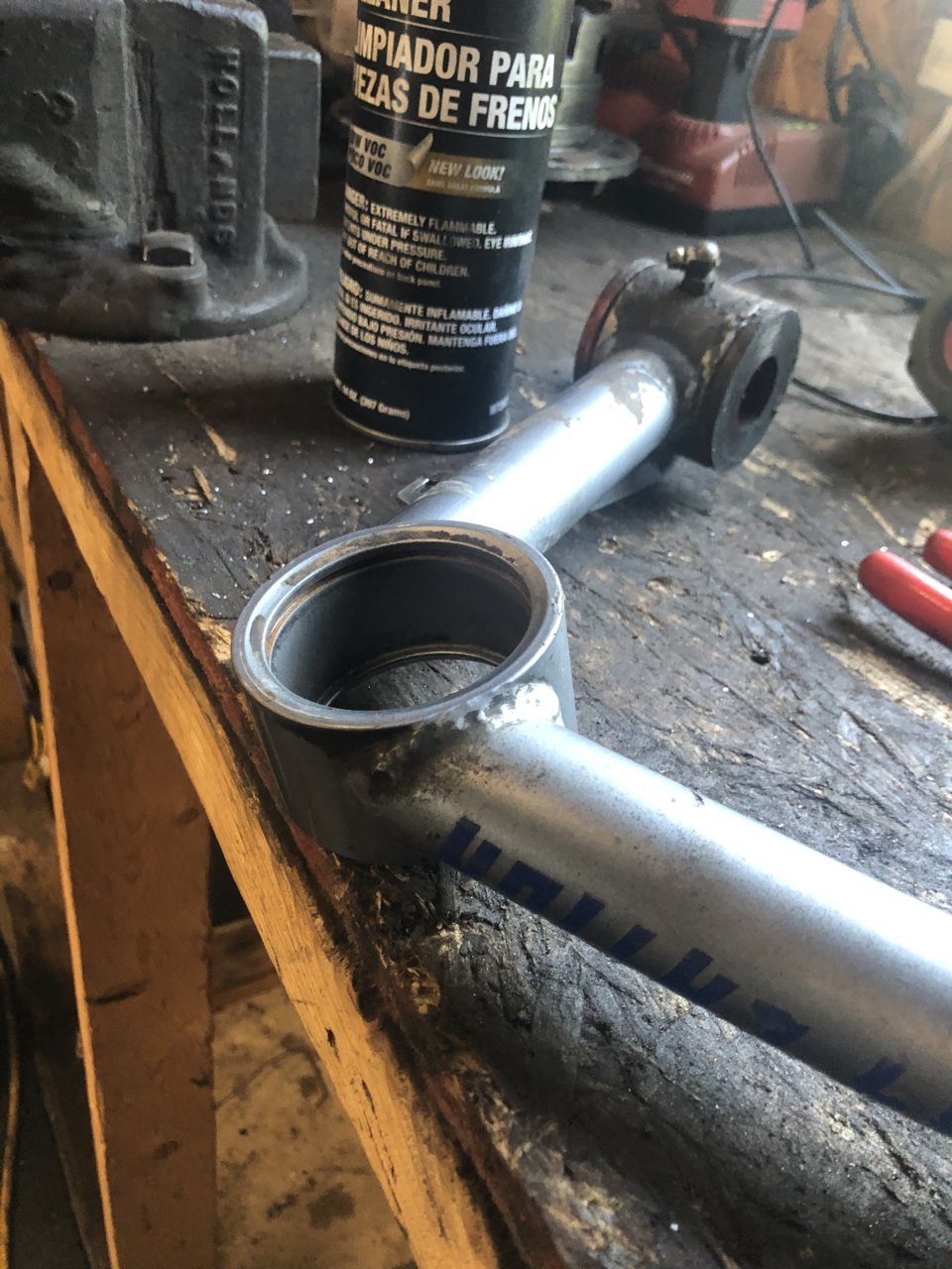

    Huge shoutout to @TOTAL CHAOS !
    I was installing double shear UCA coil tower gussets and swapping my uniballs. The uniballs came out with barely any effort on a vise. New ones slid in with antiseize even easier. I highly recommend them to anyone interested. And my old ones barely had any play after 3 years of NE winters with salt and such. :hattip::bowdown::hattip:
