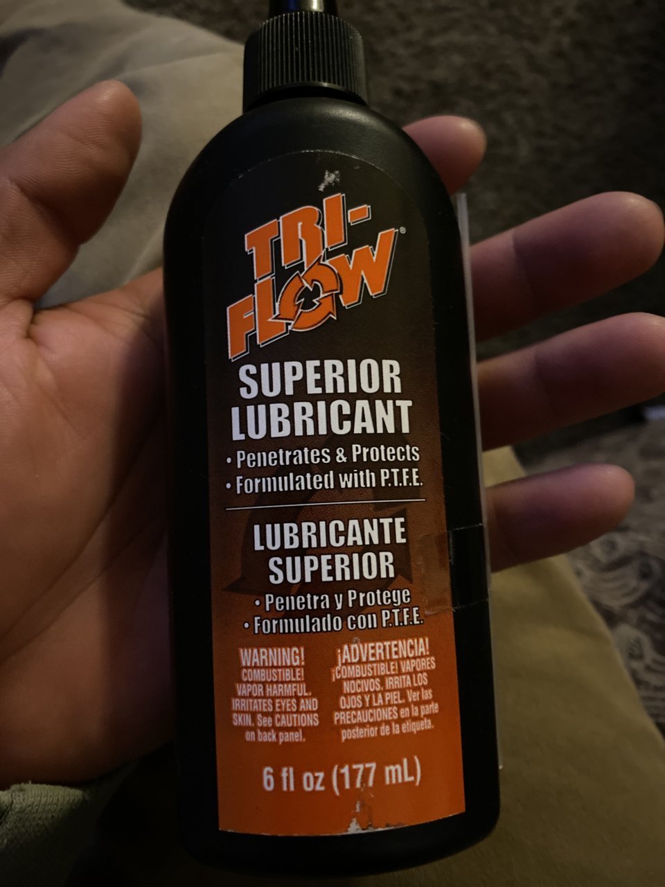

    image.jpg Can I use this lubricant for the tc uniballs?
    BOMBS likes this.
  12. Dec 29, 2020 at 9:06 PM
    #92
    fatfurious2
    Jun 28, 2014
    #132884
    48,542
    David
    Ashburn, VA
    2010 TRD OR Access Cab
    Yes
