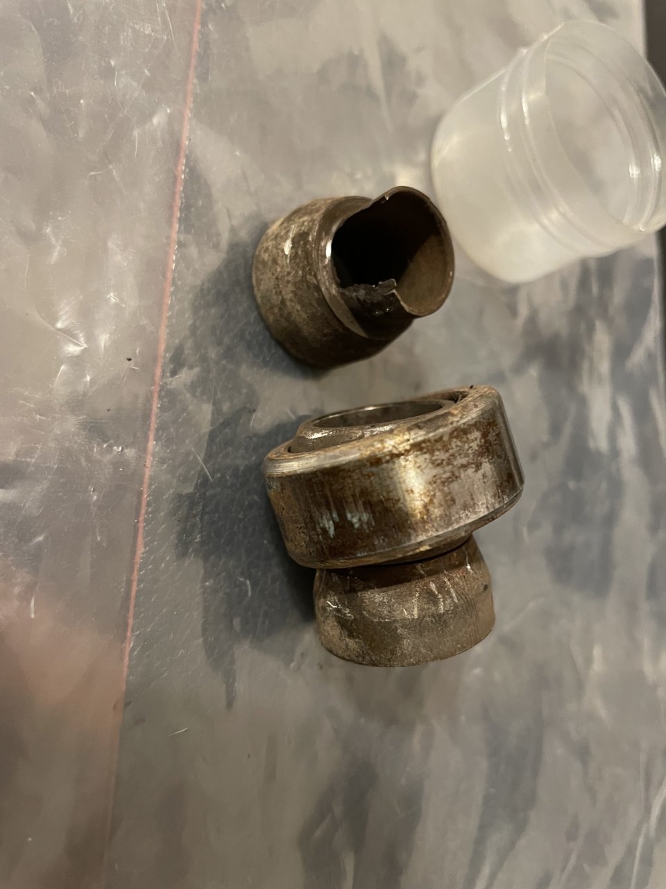

    Not sure if this will help but I also had creaking and popping\thudding sounds with my truck (2007 DCLB on King coilovers with TC UCA's). The creaking for me was solved by greasing and torqueing which seems like you do already, my result durations were inconsistent though sometimes only good for 1week or 1month. The thudding\popping I heard was actually coming from my coilover, the lower bearing and misalignment spacers were bad, after changing them out the thudding\popping seemed to not occur anymore (note, so far only city miles none offroad yet).
    My bad bearing and misalignments
