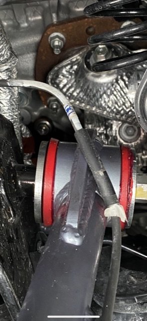

    C0E02B03-E86E-4294-AA8C-A8DA3364B3DD.jpg Hi. Is this normal? The shop installed and greased it 2 days ago. Didn’t notice it before. Will the grease eventually ooze out to fix its self. DBD9F626-2B8B-4CA9-A647-32F134CD6DB0.jpg

    I released the pressure. hope it goes back to normal.

    Did you loosen the bolt first before you had released the pressure?

    No. Should I have ?

    I had the same problem when I was re-greasing my bushings. What I did was loosen the nut, release the excess grease til the bushing goes back to normal and then re-grease the bushing with less amount of grease.

    Looks like it's over greased. loosen the bolt and release the pressure by using a pick to push the ball of the zerk fitting. Then tighten up the arm again. Should be ok.
