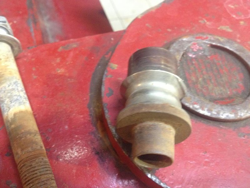

    So my truck failed state inspection this week.. Front left wheel bearing... OR SO I THOUGHT... I brought it to the dealer as its still under warranty and they state the bearing is fine... The TC UCA has a bolt goind down in throught the knuckle and apparently that is extremely loose... I mean to the point where I shouldn't of been driving it.. .The bolt either snapped inside the knuckle or elongated the hole.. They're taking it apart now and seeing what happenend... TC wants pictures of what's going on... I just bought this back in May so I'm not happy at all..

    Most likely the lack of torque. Can't really istall a Uniball backwards on a TC UCA, unless you put them on upside down.
    That or he did not install the sleeve that is suppose to go between the UCA bolt and the spindle. :notsure:

    Well per the dealer, and the attached pictures the bolt inside the uca had stripped threads.. Sounds to me that they used an impact wrench or something and just torqued the crap out of it and stripped the threads.. that's my only idea??? Now... I've had this lift since June... Who pays for the new bolt and the new knuckle.. I'm voting dealer.. see attached.

    Who installed UCA's?
  6. Mar 4, 2013 at 1:28 PM
    Large
    Large Red
    Sep 10, 2011
    #63268
    22,457
    The installer would pay for it. Maybe they torqued the bolt while the vehicle was suspended, then lowered the truck (supposed to torque it on it's own weight) causing the failure, who knows.

    dealer did.. that's what I'm thinking too... Problem is now I need a new nut bolt, and I would like a new knuckle and I want the dealer to pay the $$$

    Just to give everyone an update.. it turns out the bolt inside the balljoint was completely worn.. threads were worn right off it.. had to get a new grade 8 nut and bolt and have two sleeves overnighted from total chaos.. Pat over at Total Chaos is awesome if anybody ever needs something definetly contact him.. getting the truck back today and getting it reinspected.. what a pain in the ASS..
