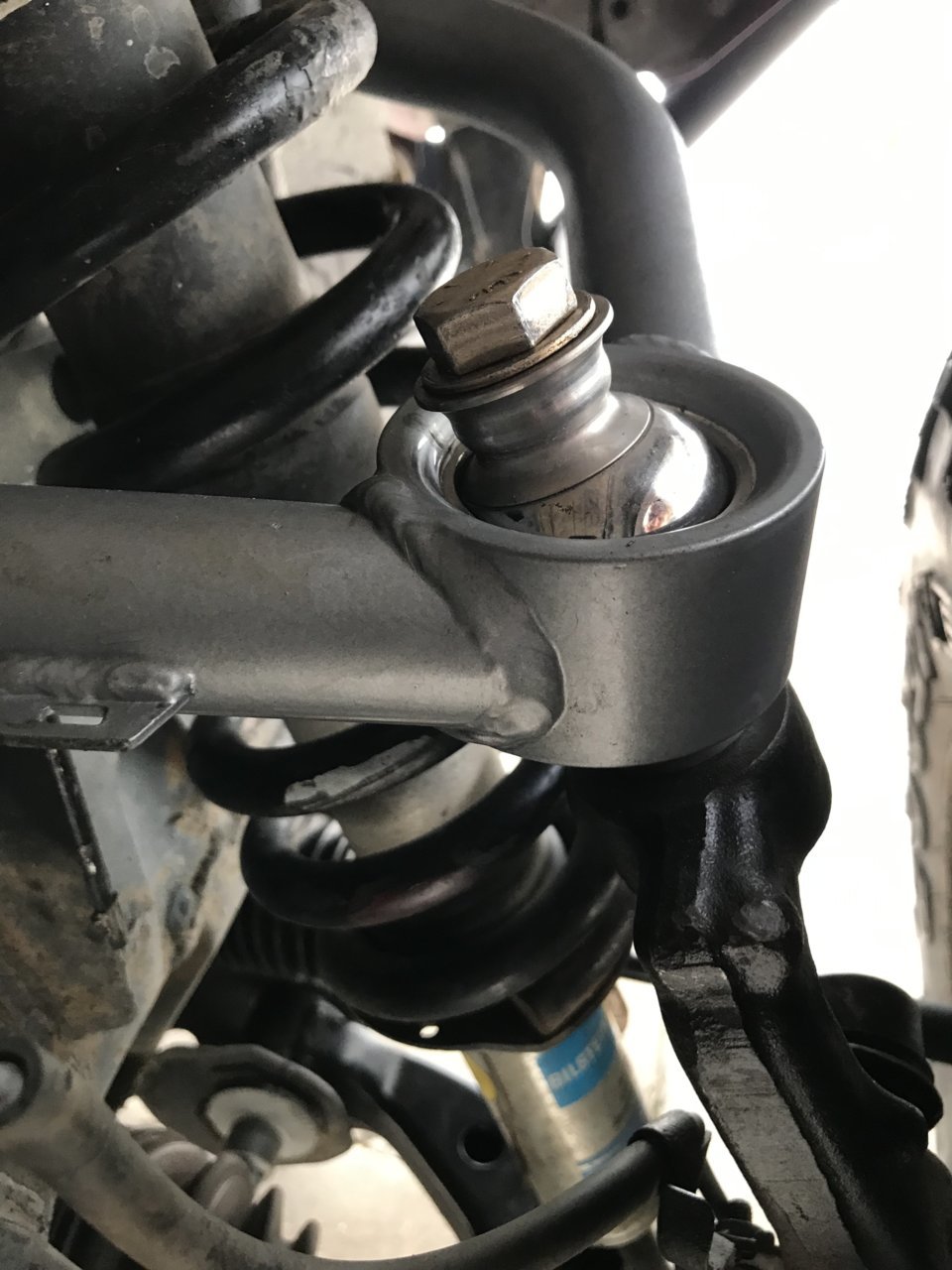

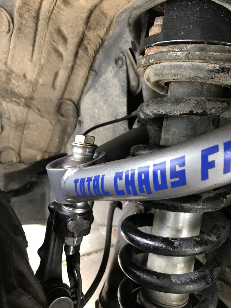

    Hey guys Im new to the site but have been reading lots a threads for a while but I put some total chaos uniball ucas on for a 3” lift and im concerned about the angle of my uniball and was curious if anyone knew how to make that angle less tense, thanks

    To much preload action going on here. Is this with the truck drooped out or on the floor?

    Its on the floor, the lift i have is a coil spacer, probably where the preloads coming from:eek:

    that spacer looks like its on top of the coilover if so , its not preloading the spring, its simple pushing the lca down to obtain the lift. that's why the angle looks like shit

    So basically get rid of the spacer and get an actual coil lift?

    Yesss

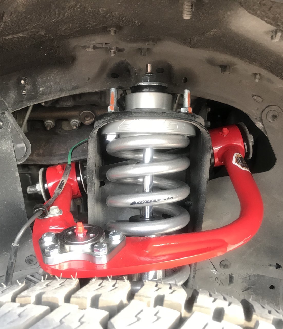

    yes, hat would be much better. many options to go with. on my truck I have toytec 3" coilovers.

    the ones I purchased are the preassembled units that use toytec coilovers on Bilstein 5100"s set on the zero setting. just remove your old and install the new complete coilover

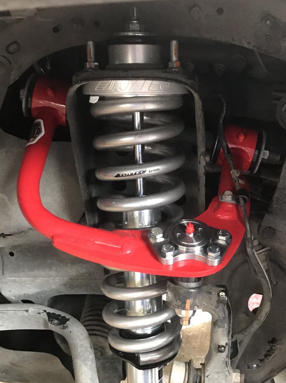

    Here’s a pic BDBA9382-B731-4908-8B06-E3FBCDB0B4E9.jpg84F6A8F4-DB51-42B3-B077-8C855436A151.jpg

    Thats a clean set up my friend:cool:

    thanks. I think the ride personally is just right. just enough stiffness for the trails and I like the way they feel on the street.

    A 3" lift from a spacer and a 3" lift from a coil are going to have the same exact ball joint angle as seen in the picture (truck on the ground)...

    What do you think would make that angle better?

    Actually they do not. The Toytec coil over is just slightly longer than a factory coilovers. When my truck is on the ground the uca is almost level. The angle not even close to the pic he showed of the uniball.

    So the toytec coils should do the trick?

    He’s a good pic. Maybe it little hard to tell. Granted I’m using jba uca’s (dirty at the moment) they use a ball joint that has better articulation than thenuniball
